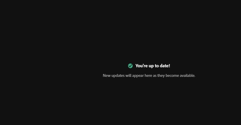

my AV is not preventing the creative cloud from updating, there is no block preventing it. As i have previously mentioned the individual programmes/apps (photoshop etc) updates all apps up to date.jpgupdate when updates appear.
