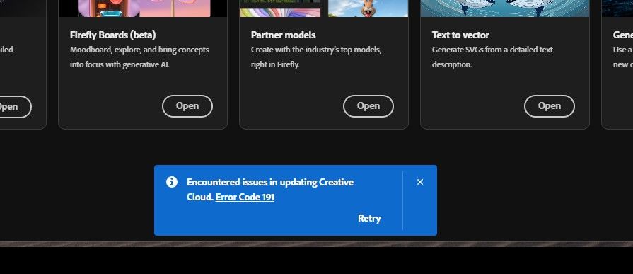

Creative Cloud fails to update (Error code 191)
Explorer ,
Jun 23, 2025 Jun 23, 2025
As the title says, the Creative Cloud app keeps failing to update. I first tried troubleshooting it with the guide for this specific error code, but nothing worked. Tried reinstalling the app and even using Adobe's cleaning tool, and nothing worked; the error kept showing up. Also tried repairing Windows 11, and that didn't work either. So I contacted support, and two different agents remotely connected to my PC, and neither of them could fix the issue or figure out what was going on.
As a little test, I decided to use a different PC, this time a laptop with Windows 11 as well and in that one, Creative Cloud needed an update, and it updated without issues. So I decided to go to the about tab in the app on both PCs and put them side by side, and strangely enough, both my main PC (the one with the issue) and the laptop are in the same version of the app and everything else below. (At the time of making this post)
So maybe this could be some sort of bug where it keeps thinking it needs to update when it is already updated?
I posted this issue on Reddit, and so far, two other people are also experiencing this issue.
Whatever is causing this issue, hopefully, Adobe becomes aware of it and fixes it.

Kglad - I clearly did have sufficient disk space?
an exact run through to avoid any confusion: (let's say we've followed your steps pre hand - removed adobetemp folder, shut down defender etc etc).
1. when my computer boots up. when the CC loads up i'm greeted with the error 191 code message (see screenshot) - this is before i have even attempted to run the update.
*NOTE: if I was to check the error install.logs at this stage I would get the one like myself and Cinnaba provided to you already (below), additionally, there would still be no adobetemp folder created in the C drive at this stage.
at this stage;
FATAL: Error (Code = 191) executing in command 'AddUWPAppxCommand' for package: 'AdobeNativeClient', version:7.0.2.14
FATAL: Error occurred in install of package (Name: AdobeNativeClient Version: 7.0.2.14). Error code: '191'
ERROR: Failed to install UWP Appx package C:\adobeTemp\ETR7595.tmp\1\Appx\AdobeNotificationClient.appx with uwpcode 1 (windows error details code = (-2147024846), error = (Windows can't provision the package AdobeNotificationClient_7.0.2.14_x64__enpm4xejd91yc because it is not installed on a system volume.)
ERROR: hdhelper exe at  failed to install UWP app with error code 1 - OS Message: C:\adobeTemp\ETR7595.tmp\1\Appx\AdobeNotificationClient.appx#@#OS_Error_Code: 0x80070032#@#OS_Error_String: Windows can't provision the package AdobeNotificationClient_7.0.2.14_x64__enpm4xejd91yc because it is not installed on a system volume.
ERROR: Failed to install UWP Appx Package for logged-off and new users with error C:\adobeTemp\ETR7595.tmp\1\Appx\AdobeNotificationClient.appx#@#OS_Error_Code: 0x80070032#@#OS_Error_String: Windows can't provision the package AdobeNotificationClient_7.0.2.14_x64__enpm4xejd91yc because it is not installed on a system volume.

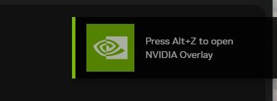

2. if I then go to run the update manually myself (via administrator as requested, though it doesn't matter, i've checked both ways - admin or not admin)...   i personally always see a Nvidia thing always flash across the top right hand corner first of the top right hand corner of the screen (see screenshot - not sure if this is linked in anyway), and then the update runs to 88% and it fails as previously advised.
NOTE: NOW, if I checked the folders and install.log failures..  At this stage I will now see error -
ERROR: Path:C:\adobeTemp already exists
ERROR: Failed to install UWP Appx package C:\adobeTemp\ETREB49.tmp\1\Appx\AdobeNotificationClient.appx with uwpcode 1 (windows error details code = (-2147024846), error = (Windows can't provision the package AdobeNotificationClient_7.0.2.14_x64__enpm4xejd91yc because it is not installed on a system volume.)
on start up loading home page .jpgNavidia seems to always up date at the same time .jpg
