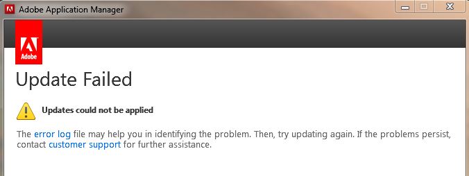

I have the same problem, I get this message each time I try to update to 12.1;
Adobe Premiere Elements 12.1 update
There was an error installing this update. Please quit and try again later. Error Code: U44M1P2003
Adobe Photoshop Elements 12.1 update

OK, I just spent the last couple of hours downloading the (supposed latest
) version of Premiere Elements 12 from Adobe website. It was 12.0. The process removed my original installation, as it was not reported and did not proceed to install the new copy I was a little confused at first untill I realised what had happened.
My system had a re-start to clear all the system processes. I re-installed version 12.0 that had been downloaded. Entered all the required serial numbers etc, started a new project and proceded to download the patch.
As you see from the screen shot all appears to be going well. At this stage only Premiere Elements was open and running.
Next I was asked to shut down both Photoshop Elements and Premiere Elements (Photoshop Elements was not running!)
Having shut down Premiere and the Welcome screen, the update continued until;
Checking the error log I get this message on an HTML page;
Reading another thread I learnt that there is another log stored in User>AppData>Local>Adobe>AAMUpdater>1.0 called aamu.log
This is a 3.7Mb error log file, the last part looks like this;
I hope you can read this. (Double click the image to get a larger view) The interesting one to me as a novice fault finder is the one that states 'No default proxy present on the user machine'.
I am running Windows 7 64 bit. I wonder is this update looking for the program in the 32 bit area?
Plus there is another error near the top that states 'conflicting process is running block Adobe Premiere Elements.exe' The program is not running'
Any thoughts out there?
Message was edited by: Macvideo
Copy link to clipboard
Copied
Logs suggest that Patch is trying to apply update @ C:\Program Files (x86)\Adobe\Elements 12 Organizer\AMT\Elements 12 Organizer\ElementsOrganizerRevelAgent.exe.
It seems some registry has got corrupted.
Please save all your work and uninstall PSE12 and PRE12(you need to uninstall both)
Install PSE12 and PRE12 again and try to apply patch. It should work.
If doesn’t then we can have a connect session and I will look into the machine.
Shikha

I am totally confused now!!!
After hours of messing about having tried to do this patch 4 or 6 times prior to downloading a new trial version that came out to be the same version 12.0, I tried again to update the patch. At least 5 or maybe 6 times I tried and got the same results as I show with these screen shots.
I had decided to give up and continue with my video project. Out of curiosity I checked the 'About' tab on the help menu and found this; Version 12.1 (20140225.12.1.620828). I thought that must be an error, then I tried the text style changer which only worked once in version 12.0. It worked correctly, I can now change text styles as often as I like without having to shut down the program!
The daft part is, my 12.1 version still claims there is an update and it still crashes out with the same error code you and the rest of us is getting when I try to update. I must have a half fix.
Signing off as totaly confused.com!
Copied
PRE12.1 patch applies to both PRE12 and Elements Organizer 12.
The patch was somehow able to update PRE12 but not Elements Organizer 12.This is why you can see updatedversion of PRE12 on your machine.
But it is recommended that you patch both Organizer and PRE12 to avoid any discrepancies.
Can you pelase share PSE12dot1Patcher.log(you will find them in %temp%) at shigoel@adobe.com for looking into the issue exactly?
Shikha
