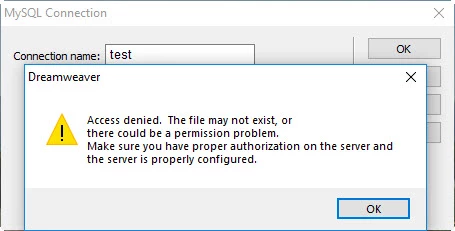

While creating a new site in CS6 through the "Manage Sites" interface I'm able to create and connect to my webserver without issue so the FTP is working as expected. I've also checked that this connection will be for REMOTE and TEST and I realize this is not an effective way to do this but for now it will have to suffice. My problem seems to be while trying to create a connection to the database through the MySQL Connection popup. Supplying my connection information gives me the following message:
The same credentials (username/pass) can be used via PHPMyAdmin without any issue which leads me to believe something else is a miss. So I'm trying to narrow down the possible causes of this issue and could use some assistance.

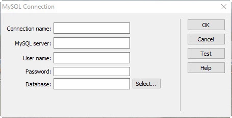

I have a few questions if I may about the connection popup.
1-when server information can I use a hostname or does it have to be an IP and should it contain the port number the MySQL server is running on?
2-if the server is running on SSL does that create issues for the connection?
3-is there an actual log being created of the connection attempts being made while choosing the "Select" button?
Thanks for any assistance you could supply.

Also in your screenshots, have you left the databse name empty when attempting to connect to remote database?
.....Also on your local set up of MySQL have you set up the user with the desired password?
I've tried both options, using the "Select" and adding the actual DB name both with similar results.

I'm assuming here you are trying to connect to MySQL at your web host remotely?
What have you got in the MySQL Server field in Dreamweaver?
Also, you may want to check with your host that they allow remote connections to MySQL, most do not but if you have CPanel for example there is usually in the DB managenet section of CPanel a section called 'Remote MySQL' which you would need to add your IP to.
Paul-M - Community Expert
January 9, 2019
Thanks for the reply.
I am trying to remotely connect but have also tried to connect via localhost with a version of MySQL locally installed with no success.
I have tried a number of combinations with no success but in general I've tried both the hostname or IP address of the remote MySQL server with and without the port number.
test
x.x.x.x:3306
myusername
mypassword
test
x.x.x.x
myusername
mypassword
or trying to use also the localhost version of MySQL installed with similar results
test
localhost
myusername
mypassword
Ben MCorrect answer
January 9, 2019
Most webhosts, by default, restrict access to the SQL server to either local requests on the server-side, "localhost", or remote requests from a particular IP address. Have you ensured on the hosting side that your own IP address is allowed to access the server remotely via the account you are trying to login with.
