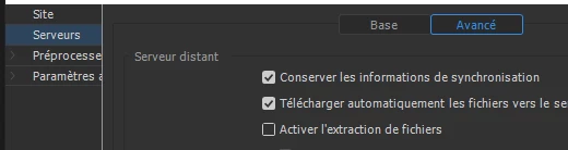

    Correct answer L e n a
    did you try to upload on save ?
    go on website settings, Site > Manage Site
    double click on your site line
    choice on the left the server category,
    then edit the remote server line by double clicking on it, you'll find the advanced tab setting
    check the appropriate box to upload on save

    although it doesn't seem to be the case, because for your first site it works, be aware that whether or not to open the dependent files dialog box is in the general preferences of DW category => Site
    but as I said previously, if the dialog open as soon as you save your file, for me that mean that you have the upload on save option checked in the first site, not in the second.

    It worked!!!!!!!!!!!! Thanks so much! Sorry about the delay, just got back from a vacation in a campsite with limited wifi.
    Just tried your advice about "upload on save", and lo and behold, it worked!!!! Whew! Thanks so much!  Thanks also to all those who wrote back and replied! Anita
