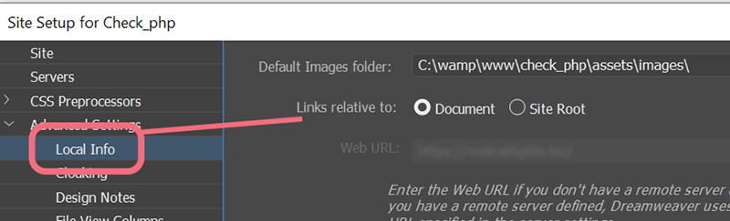

Document relative links will work better on your local computer as well as your remote server.
Site root relative links don't work so well locally because that forward slash digs down too far.
I use Document relative links for most of my projects.  Go to Site > Manages Sites > Advanced Settings > Local Info.
Assuming your local site is defined properly, DW will correctly manage link paths for you.

Nancy, my site is set up as you show in your image; but I am using the full URL in my links at present.  I "assume" by "document relative" you mean I shouldn't need to do that, and I CAN use:
   <link href="/css/my.css" rel="stylesheet" type="text/css" />
and that Dreamweaver will adapt during editing.  Am I correct?

May 29, 2021 May 29, 2021
Yes.  As I said above, when your site folder is defined, DW correctly manages site assets for you.
The file path in your Template.dwt "../css/my_styles.css" will self-adjust on child_page.html based on where you save it.
