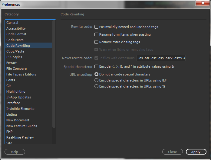

Hi anealsjc,
Can you please to double check the "Do not encode special characters" in the URL encoding area of the preferences? As strange it can sounds you need to click it 2 times to activate it (because of the special character check box). At the end it should be marked in the blue color you will see in the screenshoot.
