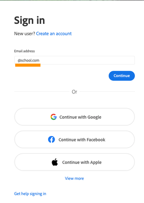

@jameso32010578 when I log in to adobe.com, we as the instructors and students we don't log into adobe.com with our email address.... if you are using an education account, when you to the adobe.com, you need to enter @schoolsdomain.com
Then it should take you to the school's learning portal, and there you can enter the user's email address and password, and enter the 2FA authentication if the school uses one. This is how two of the schools have set that up. And that's how the IT team has also instructed us to use.
