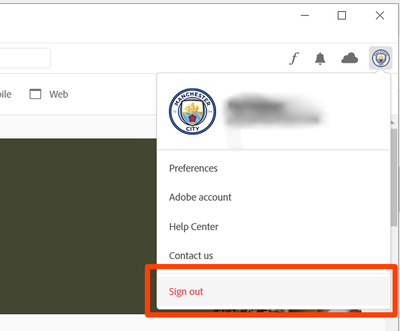

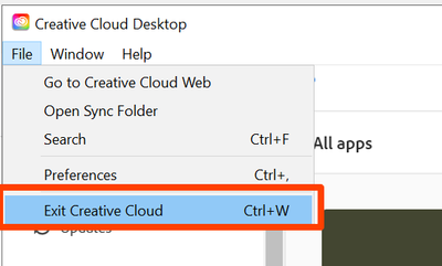

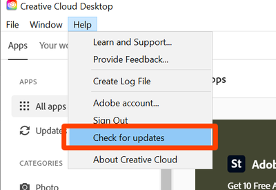

    This is for all the people that have an active Full or or Student/Teacher Creative Cloud subscription. There has been an ongoing issue with Fireworks asking for a serial and running in trial mode, despite the user having a legitimate Creative Cloud subscription. It looks like Adobe have fixed this issue recently although there has been no official announcement (to my knowledge).
    Before doing the following reverse any workarounds you already have set up/tried, for example remove the 'run this program as an administrator' setting on PDapp.exe if you have previously done that.
    1) Make sure Fireworks  is closed
    2) Check the Creative Cloud app is up to date from the top menu => help => check for updates
    3) Sign out of the Creative Cloud app => click your profile icon (top right) => sign out
    4) Close the Creative Cloud app => from the top menu => file => exit
    5) Launch Fireworks and click the 'license this software' button
    6) You should be prompted to sign in, enter the email/password of your Adobe account (with a valid Creative Cloud subscription).
    Hopefully you should be back in business with Fireworks ... It still rocks, even years after Adobe abandoned it 🤟
