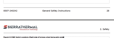

Caption with graphic keeps going to next page, for no discernable reason.
Contributor ,
Dec 06, 2024 Dec 06, 2024
I have had this problem several times, and the only way I've been able to solve it is in the Ancored Frame menu:
and selecting "page."
So here is a graphic with no caption on page 28, because for no reason, the caption has jumped to the next page. I've tried shrinking the graphic to the size of a pea, and there is PLENTY of space on the page for the caption, but it STILL jumps to the next page!
And here is the caption on the next page:
How do I fix this?

Check the /Pagination\ Keep Withs for the anchoring para, caption para, as well as preceding and subsequent paras.
Usually (but not always) FM turns out to be doing exactly what some {other?} author set or defaulted it to do.
Check the Anchored Frame panel and see if it has a Distance Above Baseline settings. If so, set it to zero (0) and always crop from the top of the frame down.
I shrinkwrap my images with their own paragraph style so the image is At Insertion Point--then my caption is set to Keep With Previous Paragraph.
Dec 07, 2024 Dec 07, 2024
Hi, @Susan305351693t3o ,
when I am right there is an anchor at the end of the caption.
If so that is your problem.
An anchor MUST always stay with table/anchored frame it belongs to on the same page.
Put the anchor in its own paragraph and not in the caption para.

Yes. That's true. The anchored frame will tear the anchor paragraph to the next page (except when the anchored frame is very large, so that the anchor paragraph and the anchored frame do not fit together on the same page).
However, this symbol at the end of the caption could also be hidden conditional text. Or an index marker.

There are any number of ways to accomplish caption-below-figure in FM. The simple an obvious one, Anchored Frame above current paragraph, does not exist. So here's one way to do it. This example presumes that what's desired are centered figures & captions.
Two task-specific Paragraph Formats are needed, arbitrarily named: FigureAnchor and Caption.
For the test I ran, these were derived from the current Body format, with the following differences:
¶FigureAnchor:
/Basic\
Alignment: Center
☑ Next Para Tag: [Caption]
/Pagination\
Keep with: ☐ Previous ☑ Next
Widow/Orphan Lines: 4 (or whatever your largest caption is +1)
/Numbering\
{probably none, due to shoving AF around}
¶Caption:
/Basic\
Alignment: Center
☑ Next Para Tag: [Body] {if any}
/Pagination\
Keep with: ☑ Previous ☐ Next
/Numbering\
{as desired}
⊥Select the FigureAnchor para.
Insert🞃
Anchored Frame…
Position: At Insertion Point
Width: / Height: {as desired}
It would be important for the preceding/following paras to not have Keep With Next/Prev set. Once in place, the fig+cap acts like a single object on reflow.
