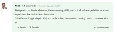

But I guess that the solution of @Matt-Tech Comm Tools also solves the problem with different absolute path to document when e.g. the customer saves the PDF files in his PC to the different folder. https://community.adobe.com/t5/framemaker-discussions/link-to-external-document-in-pc/m-p/13979303#M...
But unfortunately I do not fully understand how to procceed this in my case. Dear @Matt-Tech Comm Tools could you write me please, what to type in to the marker, to get the functional link please?

IMHO the hypertext marker should have this syntax:
message openfile path
for example
message openfile C:/FM/_zkouška/TeLi_00-00-0O/Basic HTML/TeLi_00-00-00
Please note that backslashes need to be replaced by forward slashes or escaped. Blanks are of no harm:
message openfile G:/Filetypes, special files/Dir name with blanks/FM with blanks.pdf
message openfile G:\\Filetypes, special files\\Dir name with blanks\\FM with blanks.pdf
