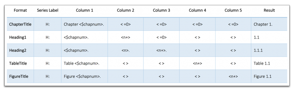

OK, you can name your formats however you want, and you will need to add the appropriate punctuation, etc. Here is the basic setup:
H:Chapter <n+>< =0>< =0>< =0>< =0>
H:Section <n>.<n+>< =0>< >< >
H:SubSection <n>.<n>.<n+>< >< >
H:Figure <n>-< >< ><n+>< >
H:Table <n>-< >< >< ><n+>
Since you may have multiple chapters in a single FrameMaker document, you can't use the <$chapnum> building block because this can only have a single value per file.
It is still not clear to me if you can have more than on

If your figures number consecutively within a chapter and aren't dependent on the sections, etc., you can put them in their own series.
F:Figure <@chapnum>.<n+>
It is still not clear to me if you can have more than one Roman numeral list in a Section or Subsection, etc. so I am proposing a separate series for these:
Step_1st:
R:<r=1>
Step:
R:<r+>
Since these can appear anywhere, you need two formats; one for the first step and one for the rest of the steps in a procedure. There is a way around this in some circumstances, but I don't want to suggest it because I am not familiar with your documents.

I never use <$sectionnum> or <$subsectionnum>. The way I understand it, these are used when your book has folders or groups. The way I have set it up always works for me. Anyway, all of the <$...> building blocks can only have one value per document so they won't work for what you are trying to do.

Whenever you leave out a placeholder in a series, < =0> is implied. That is what was resetting your Figure numbers. You need the < > placeholders so that your Figure and Table titles don't reset.

So like the table that I copied from @BarbBinder's blog post indicates except column 1 would be replaced with <n> <n+> etc.? In my current document the figure numbers are counting towars the section counter. In order for this to not be the case would they need to be their own series? Or is there a way that I can set them up to number seperately i.e the Chapter Section numbering that works
Chapter 1                                   Chapter 2
Section 1.1, .1.2, 1.3                 Section 2.1, 2.2, 2.3, 2.4
S.Section 1.1.1, 1.2.2, 1.3.3      S. Section 2.1, 2.2.1, 2.3.3
But since the Figure and Table numbering is in the same H: Series it numbers 1-1, 1-2, 1-3 in succession with the Chapter, Section, S.Section numbers so the flow would follow
Chapter 1 , Section 1.1 S. Section 1.1.1 Figure 1-1 Section 1.3 S.Section 1.3.1 when it should be Section 1.2 after Figure 1-1
