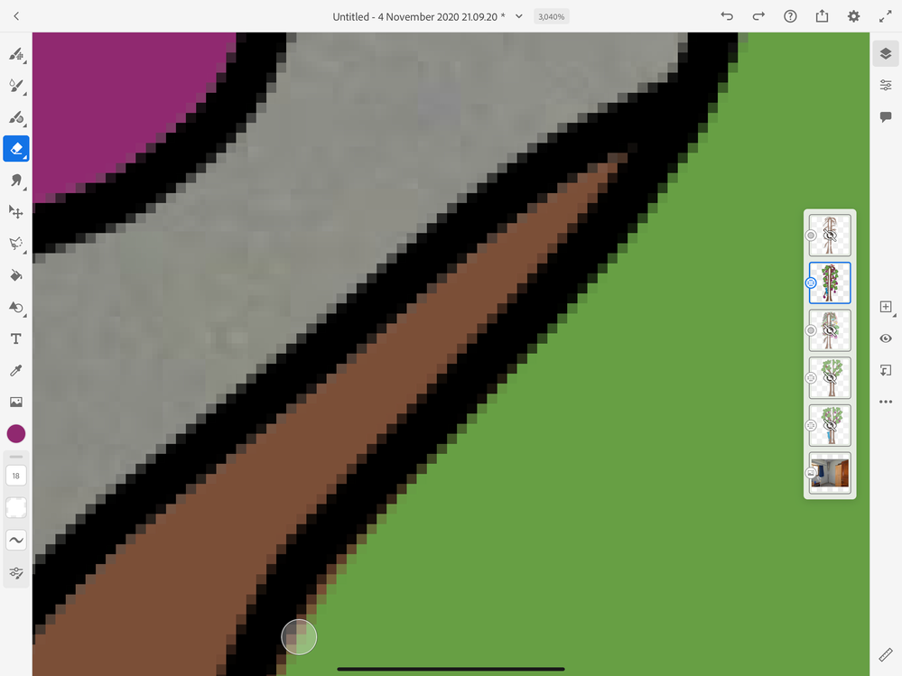

Thanks for the reply. I assumed Fresco would use vector in the same way as Ideas and Draw? Maybe I'm being overly demanding, but the difference doesn't seem slight to me. I'm attaching some close ups close ups for comparison. Fresco is the top one, Draw next, Ideas at the bottom.
9C380F81-A1D8-4BC2-96E3-DC366903BC59.pngA33E2242-05C1-437F-A124-5CBD776456E1.pngD37465EE-D44F-4C61-A8EC-01DEA2CD9A6A.png

To answer your question, yes, I'm using v.2.0.5. It isn't a problem of export, though. The pixelation is occurring in the app itself. I have an image with two layers, both of which were made up of several merged down layers.  One of these layers is crystal clear; the other isn't. Yet they were drawn in an identical way.
My memory is that during one of the merge downs, the fuzziness suddenly appeared. Initially, it was only in the layer I was merging down, but as I worked on the merged layer itself, the fuzziness seemed to spread.

I know you work primarily with the vector tools but you're not by any chance merging a Vector Layer with a Pixel Layer or a Vector Layer with an Image Layer are you?
As soon as you merge a Vector Layer with either of those two layer types it becomes a Pixel Layer.

I'm beginning to think I must have done this - inadvertently.
I've been fumbling around so much trying to get to grips with Fresco anything is possible.
Occasionally I've selected a pixel brush by mistake but I only need to do one stroke to realise my mistake. However, I think I must have switched layers after doing this without undoing the brush mark and then merged that layer down later thinking it had something else in it.
