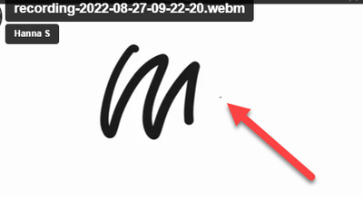

Thanks for your response, Dave! I'm confident I did not tap it accidentally. I attached a video in which it happens several times. I first thought it was a pixel brush problem but it seems it also appears with the vector brushes. It seems to happen maybe half a second after I press Ctrl+Z and the dot appears wherever my cursor were at when I started the stroke. This too puzzles me since the pen sort of replaces the cursor when I'm using it. To straighten out the setup; I'm on my desktop computer using a drawing pad and a keyboard. I also have a mouse connected, using it sparingly when drawing in Fresco though.
Aug 28, 2022 Aug 28, 2022
Do you have a Wacom mouse sitting on the tablet, in addition to the pen? It looks like a second device is providing input but just sitting in a static position. I have seen behavior like this in Photoshop, so just wondering.
Before the blotch appears, and while you're drawing, it appears there is a second device cursor just sitting there, right where the blotch appears.

I have a mouse connected to my computer too, yes, although this has never been a problem for me before. And with all the other programs I'm using the pen replaces the cursor and I have a seamless expericence switching between pen and mouse. This has worked for Fresco too up until this update.
