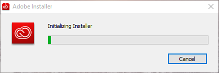

Anyway, my problem begins a lot earlier than that... I downloaded the "CreativeCloudSet-Up.exe" and ran it. After asking for permission and clicking "Yes" this window pops up
That's the usual, I've done it before.

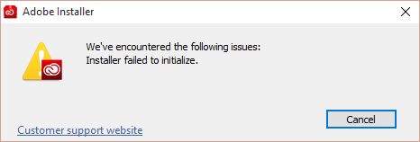

The problem is that the status bar doesn't even get to the middle and the installer closes. It doesn't show any error, or bug or anything I could use as a reference to report the error. It just closes and nothing happens after that. I've repeated the process many times. I've tried running it as an administrator (even though my user IS an administrator) and when I do it this happens

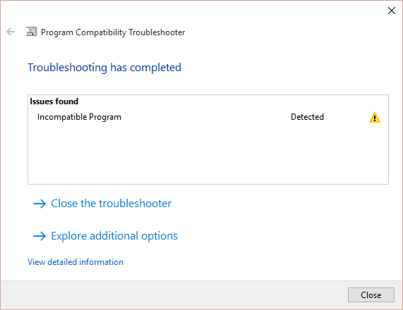

I even tried the "Program Compatibility Troubleshooter" and when I tried running it with Windows 7 compatibility, the same error from the first image happened. I then tried reporting it to Microsoft and checking for online solutions and this is what showed up
