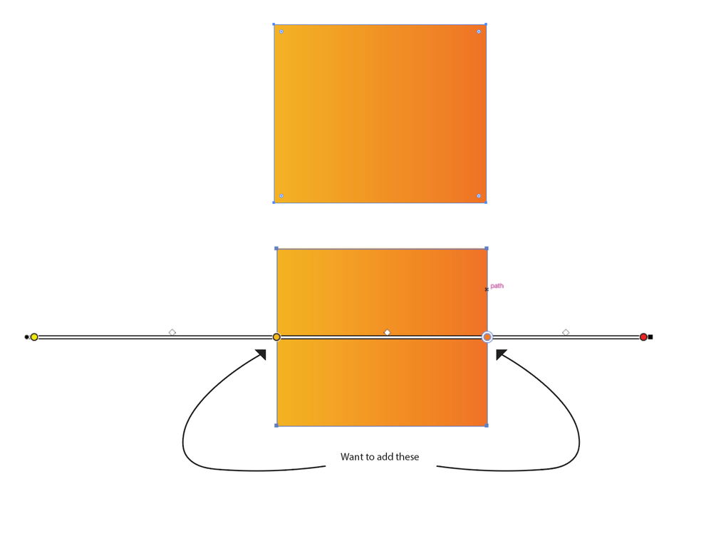

Essentially what I'd like is to add gradient stops to an object where the gradient starts and ends way beyond the object. I want to add a stop at the left and right bounding box edges. This works easily manually by just clicking on the gradient band, but I have dozens that need to be updated.

So the gradient and object already exist, so the script doesn't need to create the gradient. Yes, I do want to add stops in between, but not at chosen or specific percentages. I wanted to know if I could script it to determine bounding box of object and add a two new stops at points equivelent to that object's bounding box. See picture.Screen Shot 2023-06-29 at 2.59.05 PM.png
