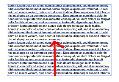

I believe you are trying to use pathfinder >> Divide on an area text container. You need to outline the type . First.
Screen Shot 2020-09-22 at 2.54.55 PM.pngScreen Shot 2020-09-22 at 2.55.07 PM.png
Or maybe you are trying to split 1 text container into 2. You just need to select hollow arrow tool and drag this bottom of text container up.
Then option drag to duplicate a copy, and remove the type (1st paragraph in this example).
Community Expert , Sep 24, 2020 Sep 24, 2020
What you can do is:
Select just the path of the area text with the group selection tool. Then copy and paste. Then put the divider path on top of it and then divide objects below. Then put the text into it.
The rectangle was filled with text that i deleted

This is super close to what im trying to do. The second method would work if I was just doing a rectangle but my shape is more complicated.
basically in your first image, if you added text to fill in the area of the word "textsplit" and then did the exact same split. I want to chop that overall shape in half that has words inside.
If the textsplit shape, never had any text in it I can get work, but once I add text within the shape nothing happens or I get that error.

What you can do is:
