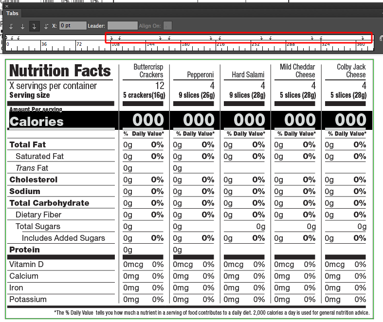

Is there a way I can grab for example the tabs within the red border, and move each to the right by 18points.
Would be great to  drag and drop around a series of tabs, and click a button to increase / decreases / scale the values in the tabs stops. Would such a feature be useful to you?

Any ideas how to do exactly what is shown in my first post. This is where I got stuck with using either the table  or characters features to make the rules. I obviously do not want rules underneath Buttercrisp, and for them to span the cell width with a 2 point gap

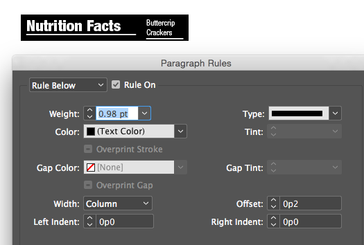

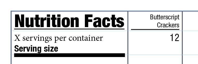

Thanks. The file you attached looked no different than mine, but no worries. Paragraph rules was a great suggestion, but do not think in the end they will work with 2 lines of type, as the rule is offset. Might be easier to manually draw the rules in InDesign.

In your first screen shot, Nutrition Facts is larger than in the last one, that's why they are offset. You don't need to draw the lines manually, for sure!

I took Jonathan file and made the Nutrition Facts larger, but you cannot get an x & y axis coordinate on the rules. Working with pargraph rules is a great idea, but if this were to eb a template for other to pick up on, I would not what a myriad of settings because likely we will get results as below with the rules being slightly off.

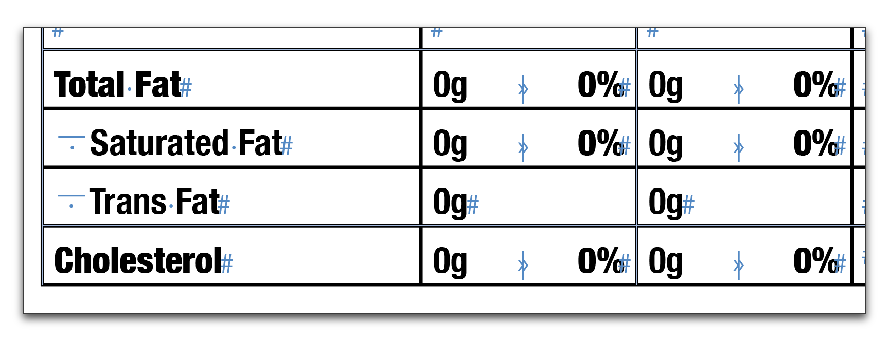

Set the row alignment to bottom. You might have figured that out by the time you got to pepperoni.

When you get to the body of the table:
I'd use em spaces in lieu of indents in the first column (to minimize overrides and styles) and use a right indent tab between 0g and 0%. In the table the shortcut I mentioned earlier doesn't work, so it's Type > Insert Special Character > Right Indent Tab.
Finally, these values repeat so if it were me I'd start with placeholder text:
  • type in the first cell
  • tap Ctrl/Cmd / to copy select the cell contents, copy
  • highlight all the other cells, paste
  • edit to the correct values

Thanks Barb I was looking for text frame options or something similar but could not find. Your screenshot was very helpful as had to select by row not character to get my tools to match yours.
Like your idea of using em spaces rather than another tab stop.
