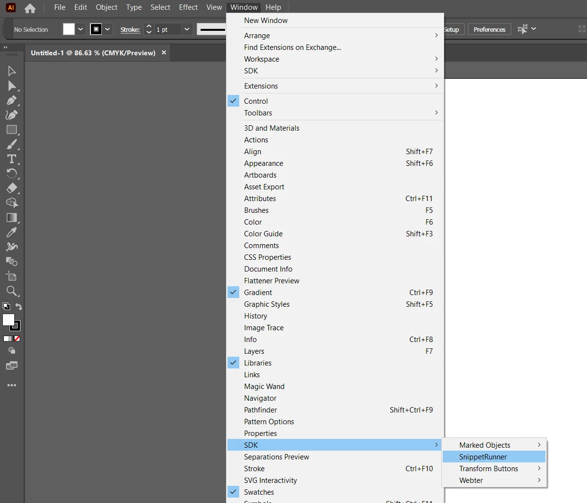

I have successfully built the MasterProjects (BuildAll.sln) on windows and all the corrsesponding .aip files have been created inside Adobe Illustrator 2023 SDK\samplecode\output\win\x64\Debug.
But when I try to run the samples from Illustrator, I do not see the UI/Dialoag Boxes getting launched.

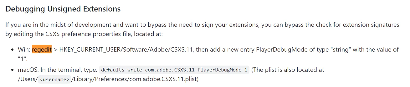

https://github.com/Adobe-CEP/CEP-Resources/blob/master/CEP_11.x/Documentation/CEP%2011.1%20HTML%20Extension%20Cookbook.mdhttps://github.com/Adobe-CEP/CEP-Resources/blob/master/CEP_11.x/Documentation/Debugging%20Handbook.md
In the handbook look for 'Debugging Unsigned Extensions'. Do the regedit and it should work... I got this pain until I actually read the whole manual!

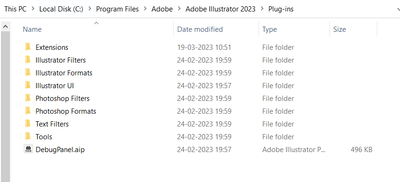

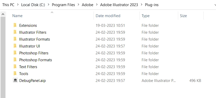

You need to copy the aip file to the Plugins folder which is placed next to the Illustrator application. Did you do that?
-Manan
-Manan
March 19, 2023
Can you send a precise location? Where inside this path? If you share a snapshot that will be really helpful.
I copied the aip files generated inside Adobe Illustrator 2023 SDK\samplecode\output\win\x64\Debug into Adobe\Adobe Illustrator 2023\Plug-ins\Extensions. But this does not help
My concern ie I am unable to see dialog boxes for e.g. "SnippetRunner" or Webter app. What do I need to do this?
March 19, 2023

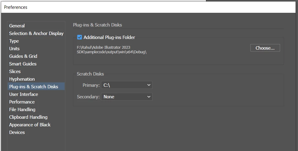

I also tried putting the aip files inside "C:\Program Files\Adobe\Adobe Illustrator 2023\Plug-ins". I think it is not a problem of location of aip files.Because, they are being correctly referred because the path has been set-up in the preferences.
