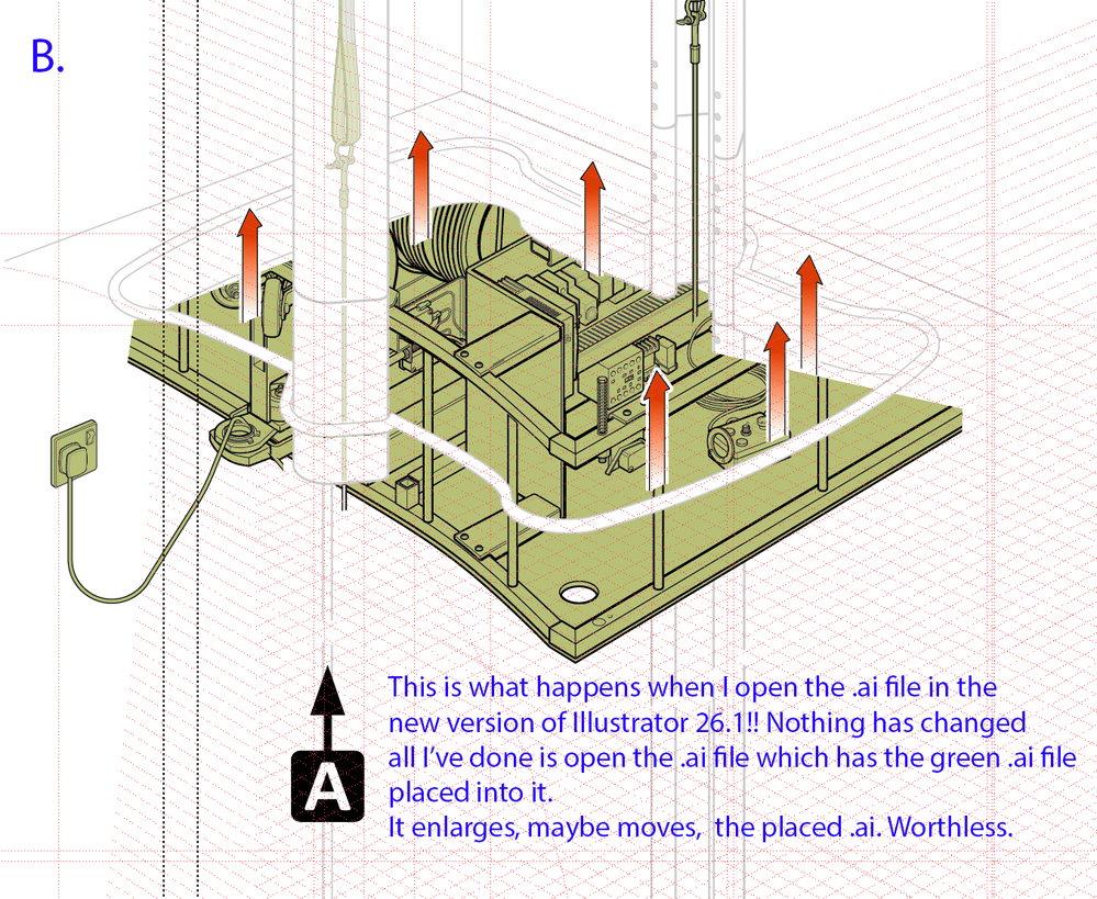

Here is an example of the placed .ai files rescaling/moving in the new illustrator. ScreenDump 'A' shows the original illustrator file (earlier version of illustrator) placed into another .ai doc and the whole lot placed in InDesign. All fine.
ScreenDump 'B' shows the same illustrator file opened, just opened nothing else, in Illustrator 26.1. Look how much the 'green' placed image has enlarged/moved!!! It's within a mask. As I said there are many versions of this, the idea being that I modify, rename, save as and then replace in Illustrator and it'd put the new version in exactly the same place, same size. That's what used to happen until a few months ago. Anyone any ideas? It'd be a mammoth task to go through the whole manual trying to scale/fit all the placed .ai files to the relevant masks.
