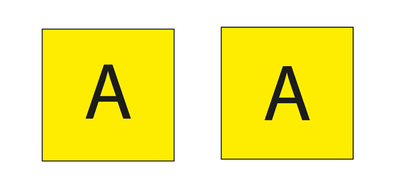

The point in Point type sits on the baseline so you can't move the point.
To see your Area Type tool, select the Windows > Toolbars > Advanced menu.
Here is an example of area type (single object) and point type (two objects), The point type on right was aligned using the Align pane. (I did not spend much time perfecting the alignment.)
