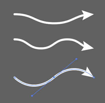

The zigzag effect set to smooth does not do it?

This is close! The Zig Zag effect does create a wavy effect that doesn't distort the arrowhead, however it's not quite the "Flag" effect I'm looking for with this solution. You can see below, from top to bottom, the Zig Zag applied with 1 segment, the Zig Zag applied with 2 segments, and finally at the bottom the flag effect I'm looking for, but I had to create it manually with a middle anchor and the Anchor Point Tool. I'm really looking to use the functionality of the "Flag" effect so that it's clean and easily editable.

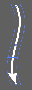

Select your arrowhead stroke, then go to the Object menu/Envelope Distort/Make with Warp. Then select the Flag warp. If you need to edit your arrowhead or stroke width, then you can go back into the Envelope Distort menu and select, Edit Contents.
Community Beginner ,
Sep 01, 2023 Sep 01, 2023
Thank you, unfortunately this still distorts the contents. I would like the arrowhead to maintain it's integrity and not follow the curviture of the wave.

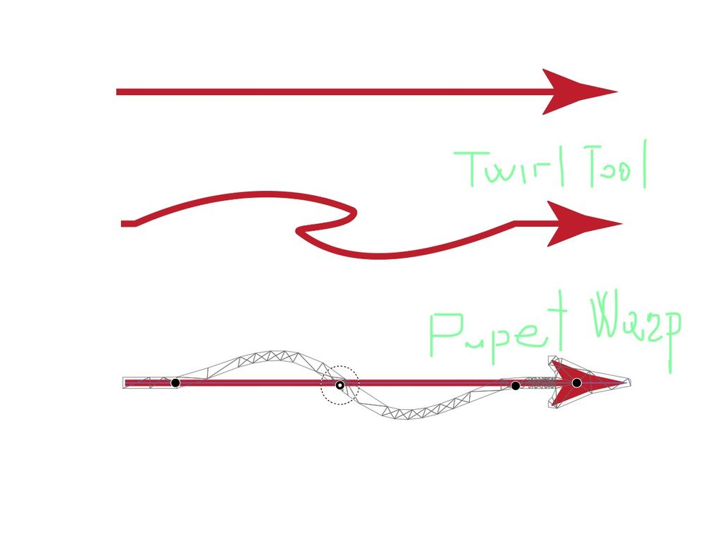

T use Twirl Tool and Puppet Warp Tool. May be this can be a solution for you?Screenshot 2023-09-01 211447.jpg.
