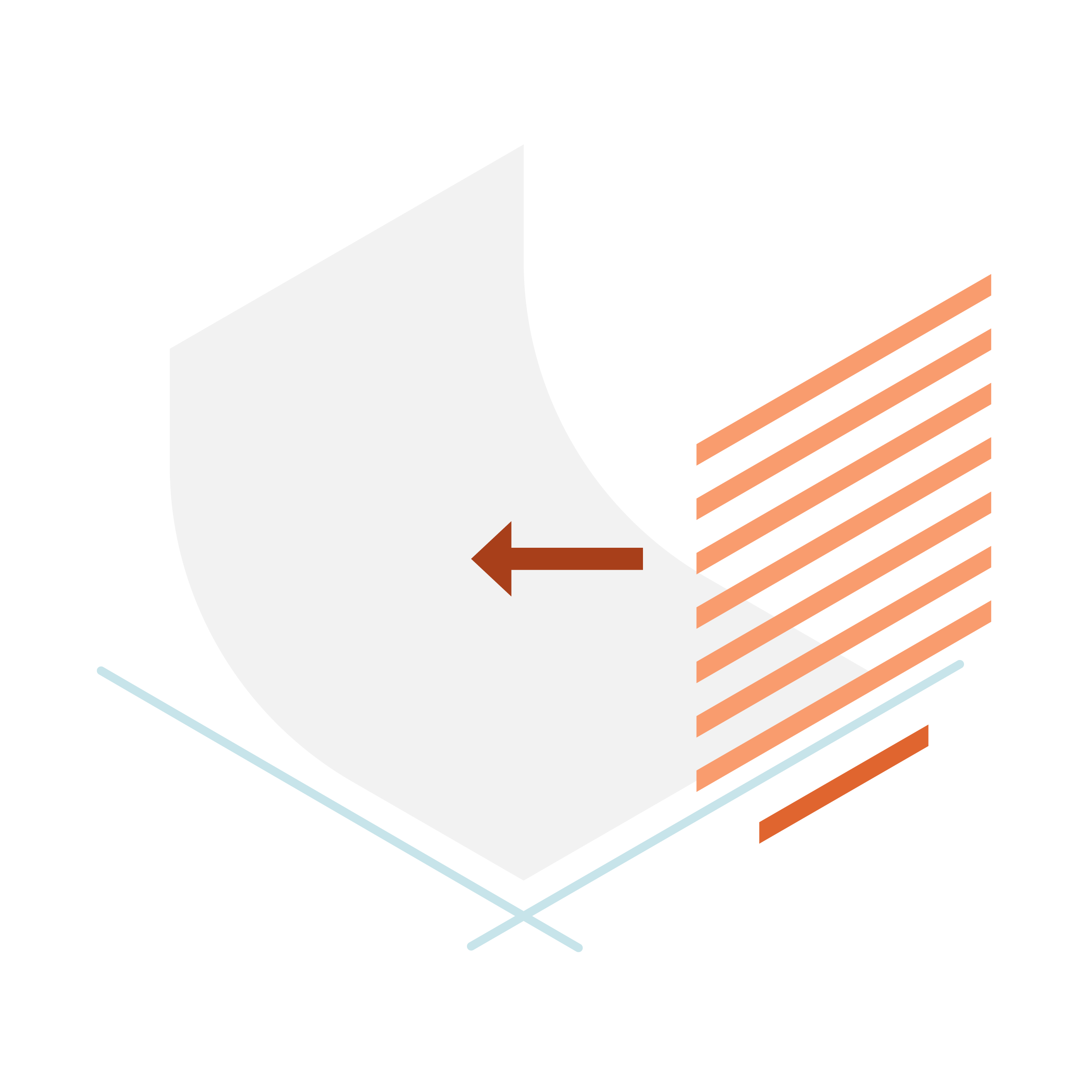

This is my very first time I have actually met struggle with Illustrator so here is a question - How do I actually bend or apply decorations/textures to isometric or any other 3D object so it actually looks like its part of it? Here is an example of icon I am trying to design with 0 success so far.
Idea is to apply symbolic text to isometric bent flat page.
It would be much appreciated if someone could give any tips or advice on how to proceed. I tried mapping art with extrude & bevel and it didnt work so I am really hopping that there is some stupidly easy trick to it ![]()

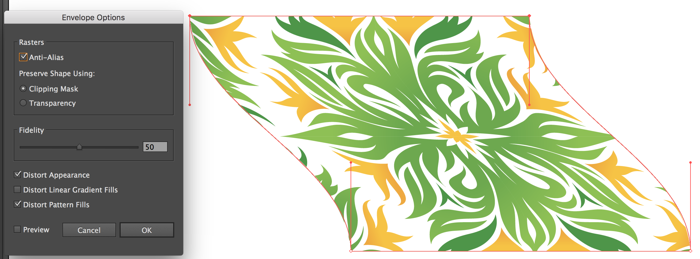

The trick is to convert artwork to "Symbol" then distort with Distortion Mesh. Also, be sure to set Distortion options to "Distort Pattern Fills".
This video may also help:

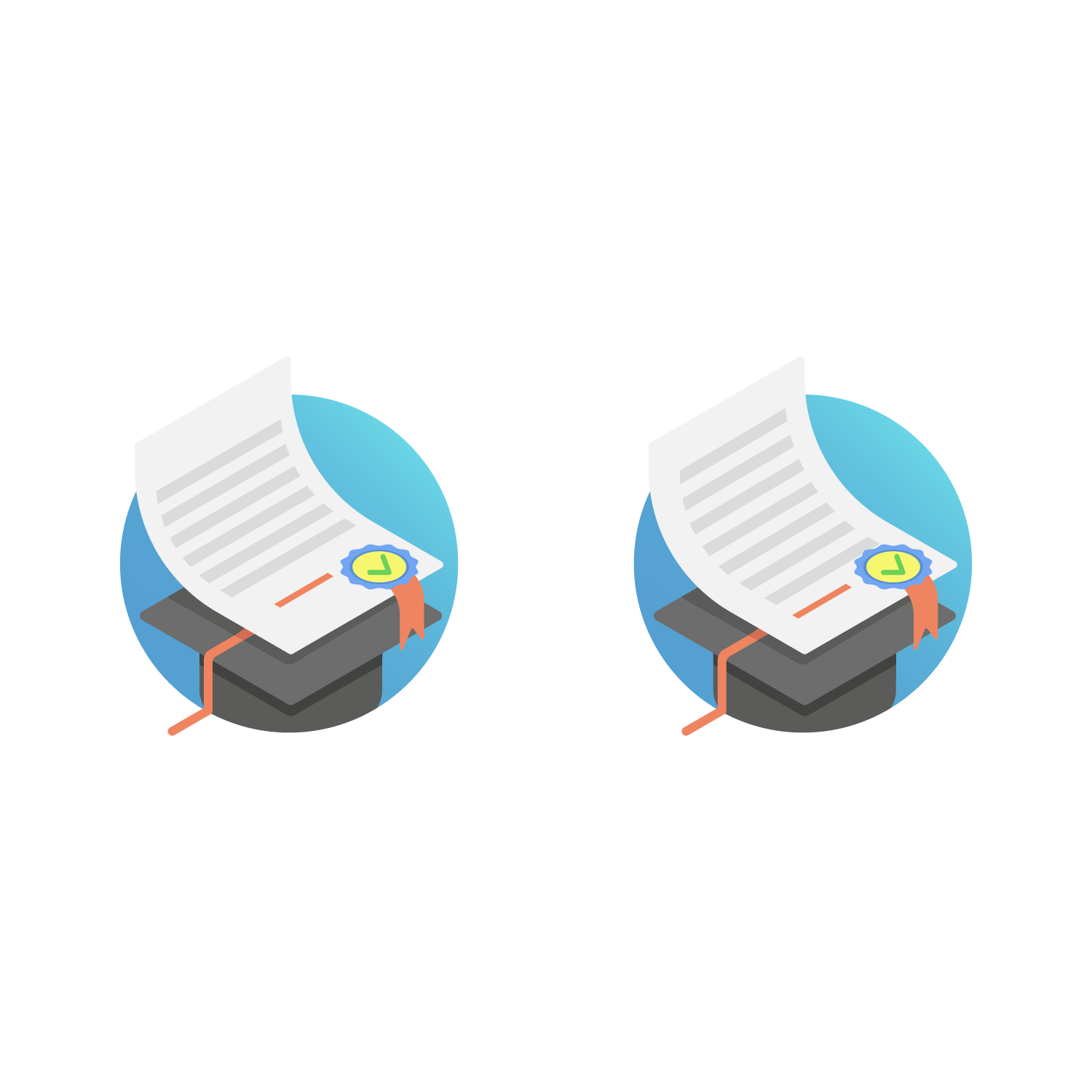

Oh wow thanks again for detailed explanation and video! I really enjoyed it and learned something very helpful especially that you can easily rotate texture with the "~" key, really didnt know that ![]()
Also here are examples side by side: on the right my struggle with envelope thingy and on the right your technique with patterns.
As you can tell mine version is worse as it makes lines of the shape very shaky and not aligned properly to the pages margin.
On the other hand yours is just perfect but still needs some tweaking.
Copy link to clipboard
Copied
Tweaked a little bit so here refined version:
Basically the key solution was just using patterns -> rotate -> offset path and after that you can just tweak patterns how you want ![]()
