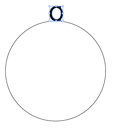

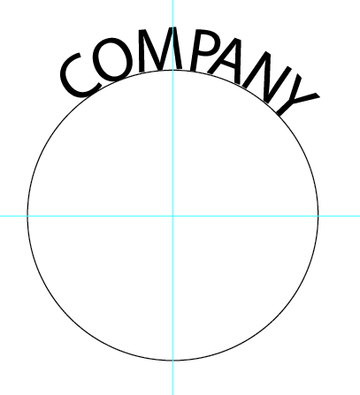

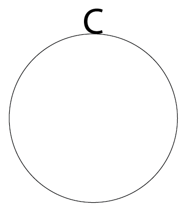

Since the "type" is not really type, this is how you could approach it.
  1. Draw a circle. Ungroup the letter shapes, if they are grouped.
  2. Put the first letter on the edge of the circle, centered at the top.
  3. Position the next letter on top of the first one.

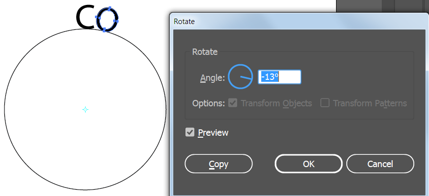

  4. Select the Rotate tool and Option or Alt click on the center point of the circle. (If it's difficult to find the center you could choose View > Outline, or you could add ruler guides.) This will open the Rotate dialog box and it will position the pivot point where you alt/option clicked.
  5. Adjust the angle and click OK.
  6. Repeat this process with each letter, one at a time.
  7. When done, you can rotate all the shapes to the position you want.
