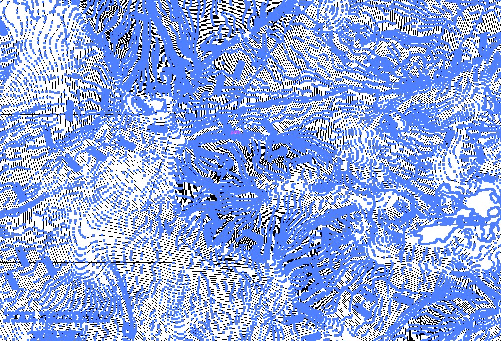

Example 1 - Area I want to crop
Example 2 - Outline mode with tons of anchor points

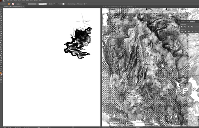

I was able to simply the art somewhat.
This is my end product:
Here is an Outline view of the edited file vs the original (I tried to keep them at relative sizes):
I brought the PDF into InDesign and printed it to the Adobe PDF driver. Not the best workflow, but it worked. Basically, anything that was showing up inside the crop area stayed intact. I tried cropping it and removing hidden data in Acrobat but the image rasterized (an old bug).
