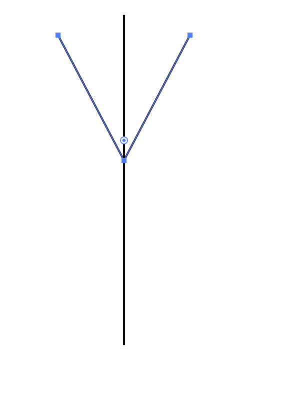

It will be there if you made changes and created and different angles.   For rectangle you need to expand . In this example it is a line.
Will be helpuful to give us screenshots!!
Screen Shot 2021-04-19 at 10.00.14.pngScreen Shot 2021-04-19 at 10.00.42.png
