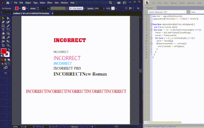

If you want it to work for words, just remove the first if statement. I only had that statement in the script to attempt to speed things up a bit. I have pasted a revised script below that will work for words and numbers.
PLEASE NOTE, this only works for finding singular words (eg. INCORRECT) not strings of multiple words. Like in the example above, you can replace the found 'word' with a string of multiple words though (eg. CORRECT WORD).
var doc = app.activeDocument;
replaceWord("INCORRECT", "CORRECT WORD");
function replaceWord(strFind, strReplace) {
  var frame, words, word;
  for (var i = 0; i < doc.textFrames.length; i++) {
    frame = doc.textFrames[i].textRange;
    words = frame.words;
    for (var j = 0; j < words.length; j++) {
      word = words[j];
      if (word.contents == strFind) {
        word.contents = strReplace;
Explorer ,
Dec 28, 2022 Dec 28, 2022
 AI FindAndReplace+WordReplaceComparison.
I may be pushing too hard, but this caught my attention. Cannot find concatenated words.
