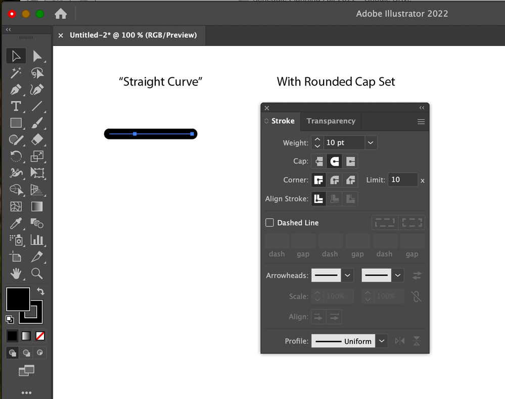

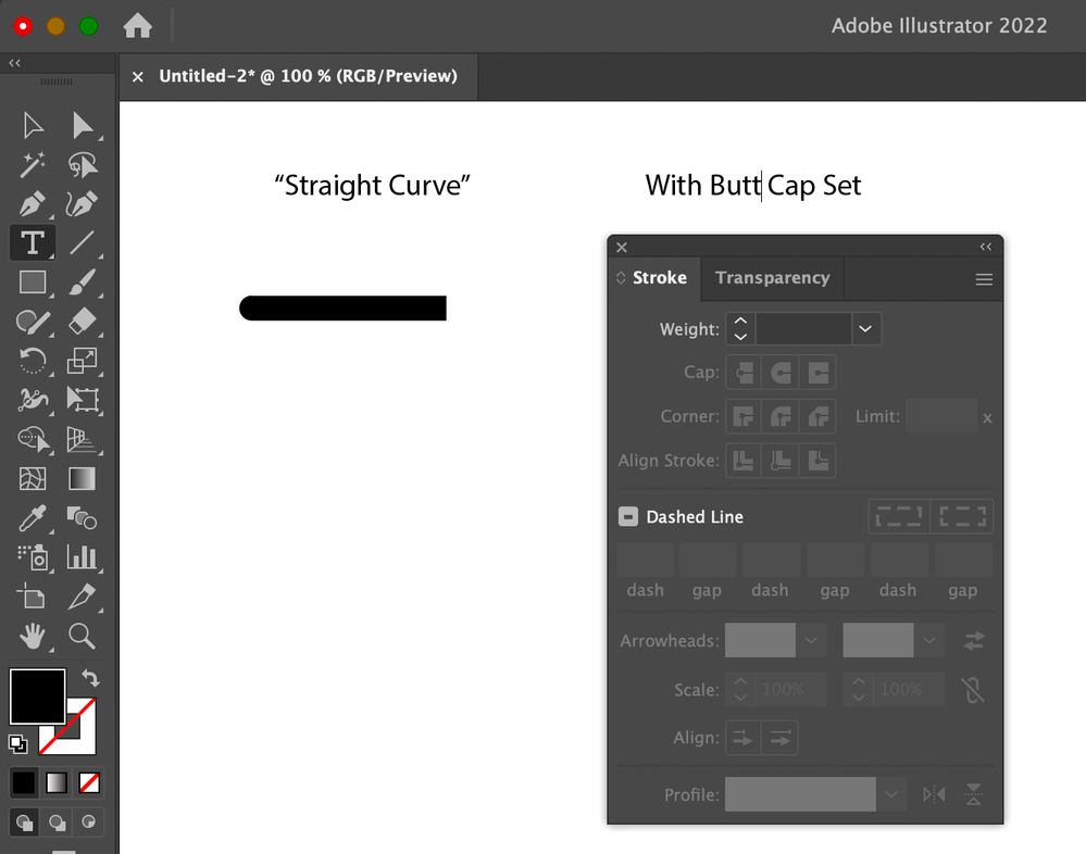

Thank you so much for your reply. I think I found the problem: I was drawing a "straight curve" not a "straight line."
When you make a "curve" segment by dragging, the cap setting only affects the endpoint of that segment, not the starting point.
When you make an actual straight line segment without dragging, the cap setting affects both the start point and the end point.  See attached 4 images to see what I mean.

Here is just the "straight curve" segment, selected with the direct selection tool, with round cap and square cap selected.
Again, when I draw a true line segment, not a curve segment, this is not an issue: both ends of the segment respond to the cap setting.

With the Direct Selection Tool:

Community Beginner ,
May 07, 2022 May 07, 2022
Toggling the cap setting between rounded and squared-off:
* "Straight Curve" changes only the ENDPOINT cap, not the STARTING POINT cap.
* "Straight Line" changes both the start and the end point to the chosen setting
Like I said, I'm ok now that I know to be careful to make a true line segment, but it was confusing until I figured that out.
