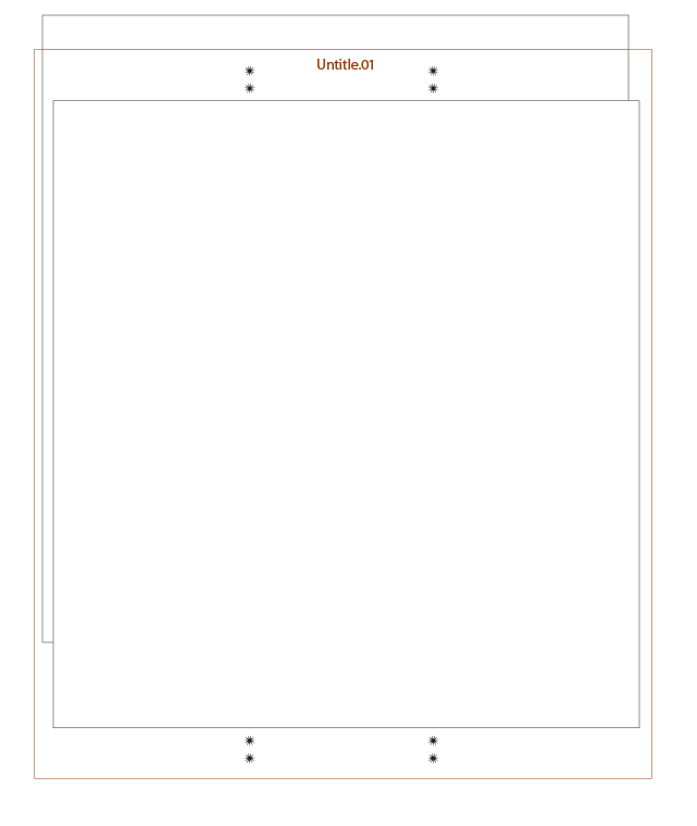

LEGEND ,
Nov 13, 2012 Nov 13, 2012
You mean like this
Corrected the two extra spaces and added the #target illustrator at the head of the script to get the ESTK to force it into Illustrator. In back is the original selection I made.
