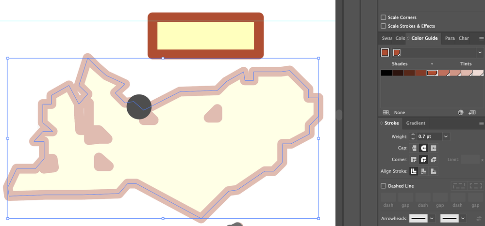

So, I am working on a document created by someone else. I've selected a line and changed the colour to a spot colour in the swatches. But I can see that although it has changed the colour it's only a tint of that colour.
I've selected the 'colour' window and have moved the slider to change the tint, but I still can't get it to 100%. I have tried changing the line to different colours, it does change but the amount of tint stays the same.

Can you show something with the line selected? Color panel, Swatches, Layers and Appearance panel (expanded).
Explorer ,
Aug 12, 2024 Aug 12, 2024
In this photo above you can see the selected line, on the right you can see the colour that the line should be - a dark orange. Above the shape is a rectangle with a line around it in the colour that it SHOULD be, you can see how much lighter the line is.
In the image above you can see on the right of the image that I've chosen the full strength tint, but it is displaying as if it is a light strength tint.

Explorer ,
Thanks Monika, I think you're on to something there. Please below:
You can see in the 'appearances window' everything looks fine, no opacity, but it looks like it's part of a group.
When I click on the group heading above it says that there's a 38% opacity applied.
I've tried to ungroup it but it must have multiple groupings as each time I select 'ungroup' it seems to still be grouped, so instead I've just changed the opacity to 100% and that seems to have fixed it without wrecking anything else. Thanks so much!!!
Glad you could solve it. WHen using the Appearance panel, there's no need to ungroup, you can just do it by double clicking that group or compound whatever in the Appearance panel and adjust what you need.
