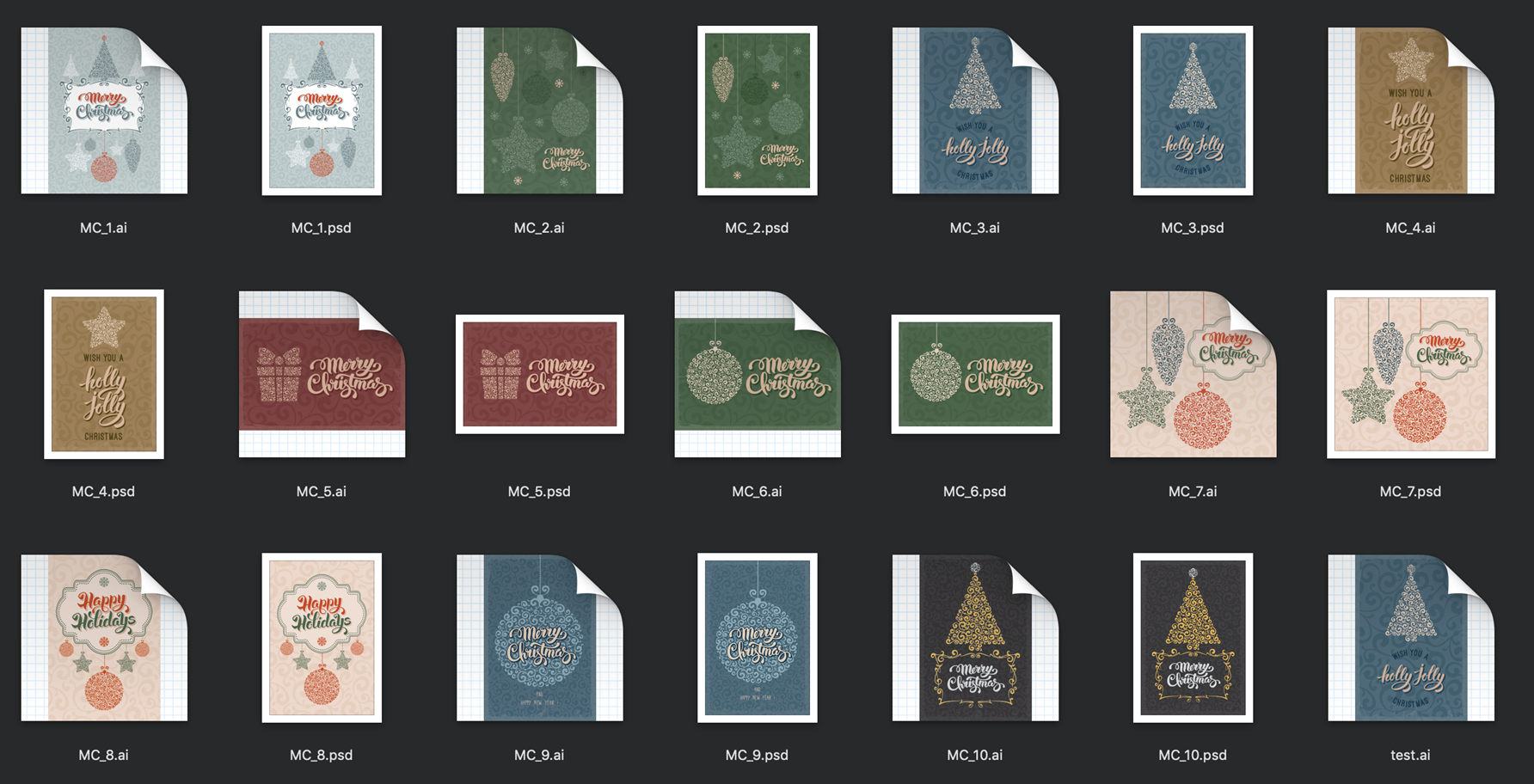

I am rejigging a few beautiful Christmas I bought on GraphicsRiver that I will print on a Xerox Iridesse Press.
I have them as Psd and as Ai files.
I then use InDesign to prepare the final file for print using mixed inks and custom spot colors.
The idea then is to print the cards with gold, silver and clear.

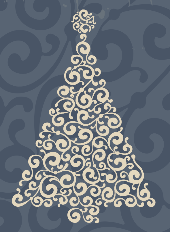

The difficulty I am facing is that on most cards, the pattern covering the entire card will also be printed using Clear toner (think spot varnish).
Clear can only be printed on top of everything else (technical limitation).
Now, just printing that pattern in clear is easy however  the challenge here is that the clear pattern cannot overlay anything else.
For example, the part of the pattern that covers the Christmas tree must be deleted otherwise it interferes and diminishes the effect in print.
The Clear would print over
the Christmas since
the Clear can only print on top
See how the two interferes with each other?
That means I need to somehow delete or clip the parts of the clear pattern that are covering anything else, from any layers or object.
Since the document is a multilayered document, I am, I admit, completely out of my depth on how to do this.
How to I cut that pattern so that it doesn't cover this or that object, given a psd or ai file that has many layers?

Probably the easiest method would be masking.
You could make a copy of the yellow layer with the Christmas tree and paste it in front of the all-over pattern. Then color the Christmas tree in black (pitch black, you can use RGB 000 or even the registration color for this). Then select the all-over pattern and the CHrsitmas tree and in the transparency panel click on "Make Mask" You then have to uncheck the "Clip" option and you should be good.

Nov 17, 2018 Nov 17, 2018
