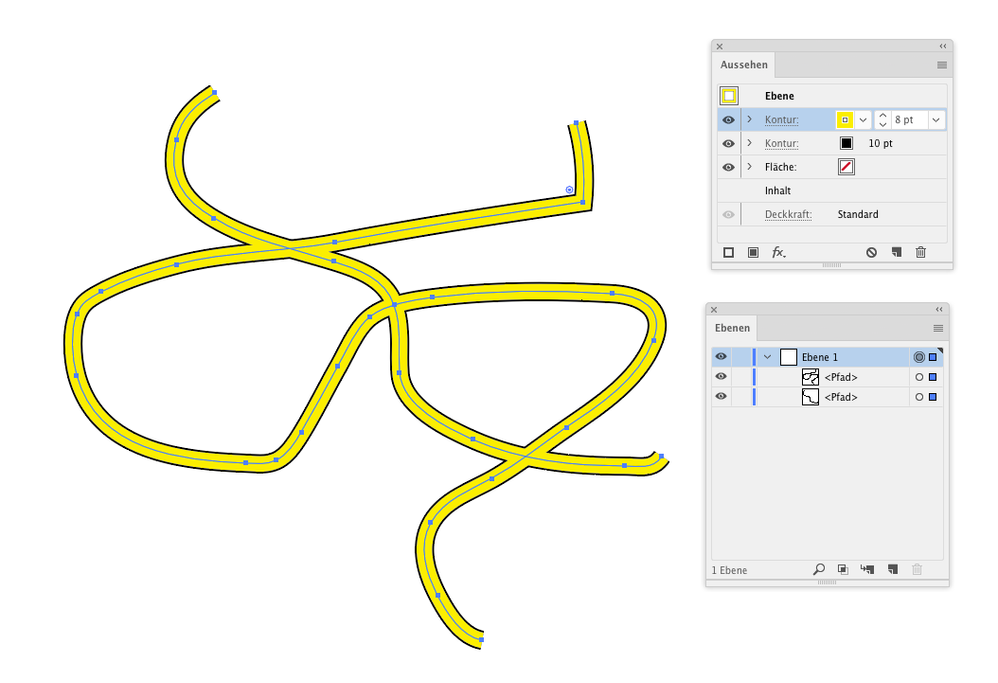

The red stroke is applied to the layer.
Open the layers panel and then click on the target symbol (the circle) of the lines layer. And then open the appearance panel and there is your red stroke. You can also change it there.

Many thanks for that... i had no idea that layers could have styles in that way. All sorted now. 🙂

You could read about the layers panel and about the appearance panel. There are several use cases for it, but I don't think each of them is described in great detail in the documentation.
https://helpx.adobe.com/illustrator/user-guide.html/illustrator/using/layers.ug.html
https://helpx.adobe.com/illustrator/user-guide.html/illustrator/using/appearance-attributes.ug.html
e.g. if you want to create a map, then you can apply two strokes to the layer (instead of the path) and you get crossroads that are easily editable. Move the paths around or edit them or add paths will add tothe roads.
