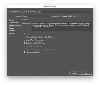

Before you export as PDF, you need to create a PDF Preset that does not include the entire Illustrator file in each PDF page and includes the bleed and shows trim marks.
Go to Edit > Adobe PDF Presets
Select High Quality Print, click the + button and give it a name.
Uncheck: Preserve Illustrator Editing Capabilities
At Marks and Bleeds check the Trim Marks, Offset 0 mm and Use Document Bleed Settings
Save the Preset.
In the Export for Screens window, check the little Cog Wheel for the PDF Settings and use the preset that you just created.
