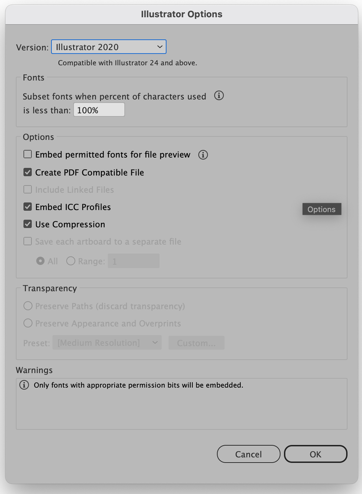

After you click on Save you should get an Illustrator Options dialog as shown in the screenshot below. It is there that you will get the option to Create PDF Compatible File. Then you can click on Okay to finish the Save.

When you save to the cloud there is no such option. If you save to a local folder using Save As… you will get a dialog with options to save as PDF compatible. So it is when you save as an AI locally that you can choose to be PDF compatible.

As Bill suggested, click further to get to the options.
Save local, the Cloud version does not have that option.
