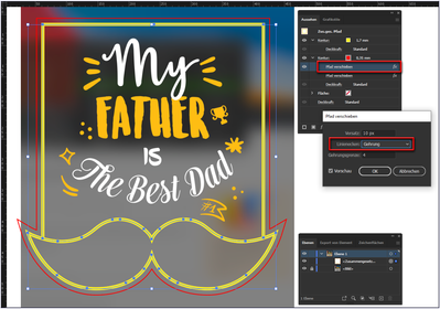

Community Expert , Aug 20, 2021 Aug 20, 2021
Instead of Offset Path setting for all paths - group your artwork and apply this group an OffsetPath EFFECT
For the second image, use two instances because of the sharp corners of the mustache.
first instance of effect: sharp
second instance of effect
After that, you can Expand Appearance to get a real path.

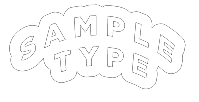

If you mean to create a dieline that follows the shapes closely like this?..
The easiest way to do that is to select ALL objects (assuming they are vector), and apply a Path offset (Object > Path > Offset) setting a size of offset you want, as well as with Rounded joins. This will create a bunch of paths that you can then Unite into one shape with Pathfinder, and delete any odd shapes that might remain inside the main outside path. Then refine the shape as desired.
Best make a copy of all the art onto a separate layer to do this so there's no danger of screwing up your art.

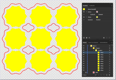

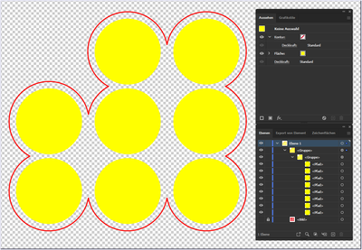

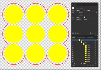

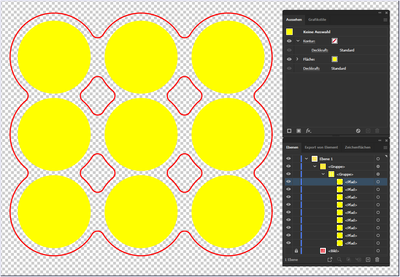

Aug 22, 2021 Aug 22, 2021
Everything is possible. Automatic, live and editable.
But you give us far too little information! 
What do you really want? Please show a sketch or upload a sample file and post the link here.
Do you want only the outer cut line or also the inner one?
Do you want the cut lines to be rounded only on the outside or also on the inside?
