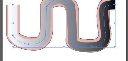

Hi thanks for this!
I'm afraid I'm still a little confused at step two and how you applied the gradient to the path (before making the opacity mask) ?
What were the steps you did to get the gradient to run along the path like this?

Also set gradient direction along stroke.
