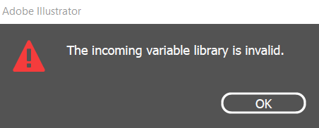

I'm trying to do a data merge using the variables functionality and it works up to a certain point. Here's exactly what I did and what happens:
  • I created the following spreadsheet, made sure all the column names/variables correspond to the object names in Illustrator.
  • I used this spreadsheet to create an XML file that I can import into illustrator as a "variable library"
  • In the Variables window on Illustrator, I chose "Load Variable Library"
  • Now what happens is that I get an error message that says "the incoming variable library is invalid". But it's weird because it works perfectly well when I use all the data up until "Vehicle_Insurance_Spending_D". Meaning, when I take all the columns before that specific column, convert that data into XML, and import it in adobe, it works PERFECTLY well and I am able to change all the dynamic variables instantly using that data sets that are imported. As soon as I include that column or any other column of data, I get that error message.

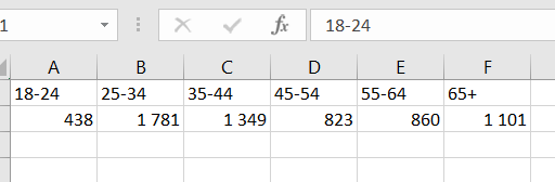

What I did is I saved the graph's data for every data set in a separate csv file, here's what the csv file for one of the graphs looks like:

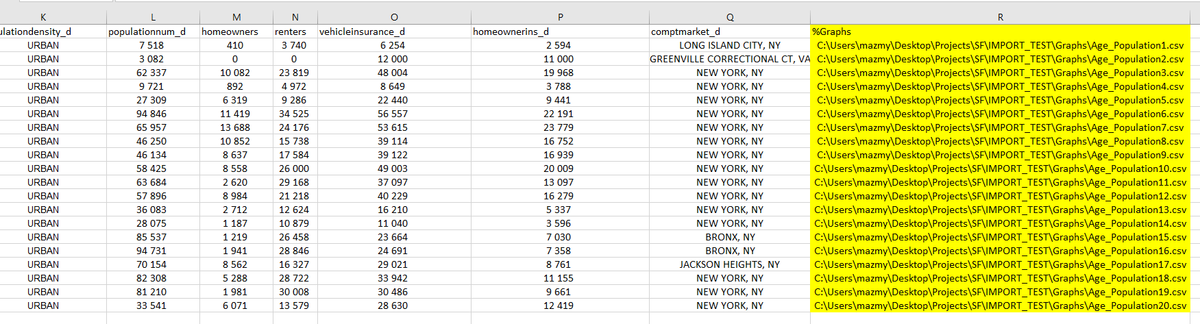

Then I linked all the csv files to the master spreadsheet, like so (highlighted):

Would you happen to know what the problem is? Every time I include the %Graphs column in my XML file I get the following error:
Thanks in advance.
May 10, 2019 May 10, 2019
What's important is how the CSV is formatted.
It needs to be comma separated. Not semicolon or anything else.
