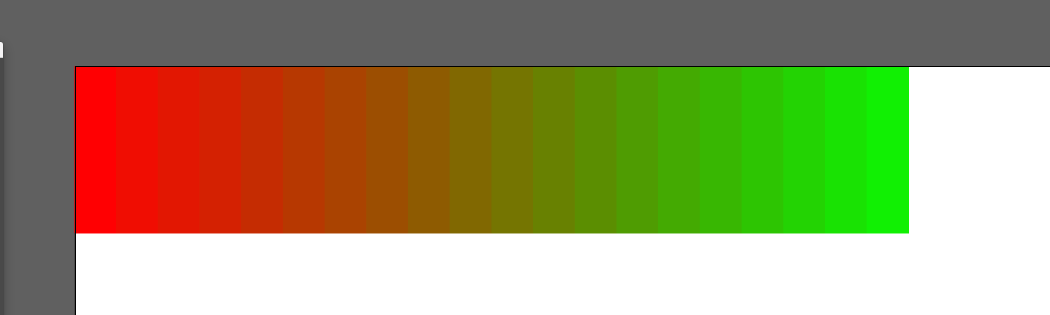

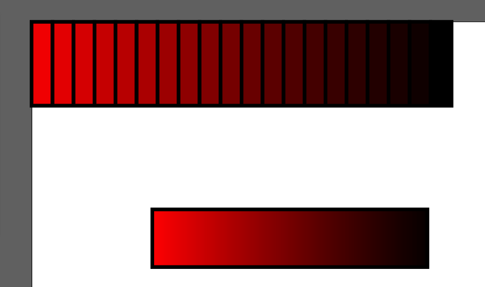

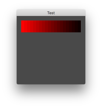

Valorous Hero , Nov 26, 2017 Nov 26, 2017
Okay I took a little break to do this exercise. Here's a function that makes the gradient array blend and then a couple of other functions to test that resulting array in an AI document as well as the ScriptUI canvas graphics.
One difference is the pathItems.rectangle() function takes (y, x, width, height), the scriptUI .rectPath() function is actually (x, y, width, height)
#target illustrator
function test() {
function makeRGBGradientArray(color_1, color_2, steps) {
  var arr = [];
  var thisArr;
  fo
#target illustrator
function test() {
  var arr = [];
  var thisArr;
  for (var i = 0; i < steps; i++) {
  thisArr = [];
  thisArr[0] = (((color_2[0] - color_1[0]) / steps) * i) + color_1[0];
  thisArr[1] = (((color_2[1] - color_1[1]) / steps) * i) + color_1[1];
  thisArr[2] = (((color_2[2] - color_1[2]) / steps) * i) + color_1[2];
  arr.push(thisArr);
  return arr;
function drawGradientInAI(gradArr) {
  var thisArr;
  var thisColor;
  var doc = app.activeDocument;
  var yPos = 0;
  var xPos = 0;
  var width = 10;
  var height = 40;
  var newRect;
  for (var i = 0; i < gradArr.length; i++) {
  thisArr = gradArr;
  thisColor = new RGBColor();
  thisColor.red = Math.round(thisArr[0]);
  thisColor.green = Math.round(thisArr[1]);
  thisColor.blue = Math.round(thisArr[2]);
  newRect = doc.pathItems.rectangle(yPos, xPos, width, height);
  newRect.fillColor = thisColor;
  xPos += width;
function drawGradientInScriptUI(gradArr, canvasArea) {
  var canvas = canvasArea.graphics;
  var yPos = 0;
  var xPos = 0;
  var width = 10;
  var height = 40;
  var thisArr;
  thisArr = gradArr;
  thisArr[0] = (thisArr[0] / 255).toFixed(2) * 1;
  thisArr[1] = (thisArr[1] / 255).toFixed(2) * 1;
  thisArr[2] = (thisArr[2] / 255).toFixed(2) * 1;
  canvas.newPath();
  canvas.rectPath(xPos, yPos, width, height);
  var myBrush = canvas.newBrush(canvas.BrushType.SOLID_COLOR, [thisArr[0], thisArr[1], thisArr[2]]);
  canvas.fillPath(myBrush);
  canvas.closePath();
  xPos += width;
var color_1 = [255, 0, 0];
var color_2 = [255, 255, 0];
// drawGradientInAI(makeRGBGradientArray(color_1, color_2, 20));
var w = new Window("dialog", "Test");
var p = w.add("panel");
p.size = [200, 200];
p.onDraw = function() {
  drawGradientInScriptUI(makeRGBGradientArray(color_1, color_2, 20), this);
w.show();
test();

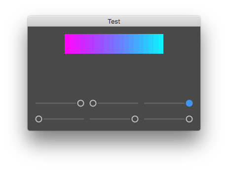

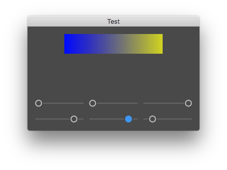

And now if we add some code for the sliders, the result ends up pretty cool! I'd say exactly what you're looking for, if I am not mistaken! (well, the drawing and ScriptUI graphics updating part)
p.size = [200, 100];
p.onDraw = function(){
var g_sliders = w.add("group");
var g_sliders_1 = w.add("group");
var g_sliders_2 = w.add("group");
var slider_1_r = g_sliders_1.add("slider");
  slider_1_r.minvalue = 0;
  slider_1_r.maxvalue = 255;
var slider_1_g = g_sliders_1.add("slider");
  slider_1_g.minvalue = 0;
  slider_1_g.maxvalue = 255;
var slider_1_b = g_sliders_1.add("slider");
  slider_1_b.minvalue = 0;
  slider_1_b.maxvalue = 255;
var slider_2_r = g_sliders_2.add("slider");
  slider_2_r.minvalue = 0;
  slider_2_r.maxvalue = 255;
var slider_2_g = g_sliders_2.add("slider");
  slider_2_g.minvalue = 0;
  slider_2_g.maxvalue = 255;
var slider_2_b = g_sliders_2.add("slider");
  slider_2_b.minvalue = 0;
  slider_2_b.maxvalue = 255;
  slider_1_r.onChanging = slider_1_g.onChanging = slider_1_b.onChanging = slider_2_r.onChanging = slider_2_g.onChanging = slider_2_b.onChanging = function(){
  color_1 = [slider_1_r.value, slider_1_g.value, slider_1_b.value];
  color_2 = [slider_2_r.value, slider_2_g.value, slider_2_b.value];
  p.hide();
  p.show();
w.show();

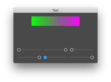

Obtain a finer display over the gradient strip by taking the width down to 1 pixel and the steps to over 200:

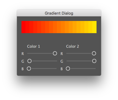

For those interest, i got the script working agian. Hope it keeps working now.
Ive also updated the UI a bit, rearranged it and added labels. The sliders also now start in the correct position according to colors_1 and colors_2
Updated UIUpdated UI

    var slider_1_g = slider_1_gGrp.add("slider");
        slider_1_g.value = color_1[1];
    var slider_1_bGrp = g_sliders_1.add("group");
        slider_1_bGrp.orientation = "row";
        slider_1_bGrp.alignment = ["fill","top"];
    var colOneBlabel = slider_1_bGrp.add("statictext", undefined, undefined, {name: "colOneRlabel"});
        colOneBlabel.text = "B";
    var slider_1_b = slider_1_bGrp.add("slider");
        slider_1_g.value = color_1[2];
    // Sliders color_2
    var slider_2_rGrp = g_sliders_2.add("group");
        slider_2_rGrp.orientation = "row";
        slider_2_rGrp.alignment = ["fill","top"];
    var colOneRlabel = slider_2_rGrp.add("statictext", undefined, undefined, {name: "colOneRlabel"});
        colOneRlabel.text = "R";
    var slider_2_r = slider_2_rGrp.add("slider");
        slider_2_r.value = color_2[0];
    var slider_2_gGrp = g_sliders_2.add("group");
        slider_2_gGrp.orientation = "row";
        slider_2_gGrp.alignment = ["fill","top"];
    var colOneRlabel = slider_2_gGrp.add("statictext", undefined, undefined, {name: "colOneRlabel"});
        colOneRlabel.text = "G";
    var slider_2_g = slider_2_gGrp.add("slider");
        slider_2_g.value = color_2[1];
    var slider_2_bGrp = g_sliders_2.add("group");
        slider_2_bGrp.orientation = "row";
        slider_2_bGrp.alignment = ["fill","top"];
    var colOneRlabel = slider_2_bGrp.add("statictext", undefined, undefined, {name: "colOneRlabel"});
        colOneRlabel.text = "B";
    var slider_2_b = slider_2_bGrp.add("slider");
        slider_2_b.value = color_2[2];
        // Interactive sliders
        slider_1_r.onChanging = slider_1_g.onChanging = slider_1_b.onChanging = slider_2_r.onChanging = slider_2_g.onChanging = slider_2_b.onChanging = function() {
            p.hide();
            p.show();
    w.show();
callDialog();
Advisor ,
Aug 11, 2021 Aug 11, 2021
@oneDegree  @Silly-V  @CarlosCanto
I have working code for the color picker in Photoshop, it took me some time to get it to work with Illustrator. Quite baffled they dont have the same code usage for stuff like forground color and background color. As well as for calling the color picker.
For now it work in illustrator, i had the code working for Photoshop already. I check if i can make this "sort" of universal for both apps.
I still need to some work, but the color picker updates the sliders and also updates the gradient. The sldiers dont update the color picker preview color yet. But that wont be much work... 😉
here's a preview, i used dropbox to much hustle to get it on youtube
Preview with color pickersPreview with color pickers
Explorer ,
Nov 27, 2017 Nov 27, 2017
This is absolutely amazing, and exactly what I had in mind - appreciate your work on this tremendously!
Will play with this, and share with the original script creator.
Again, thanks!
Advisor ,
This script also seems to have gotten broken due to this community update. I dont see anything drawn in the panel. I need to figure out where to place the [i] and see why it wont draw anything.
My first check was to see if declared variables get through into the functions. I noticed that p.onDraw function should draw the color rects. But when i add an alert inside the function which tells me what color_1 is, i dont get anything in return.
