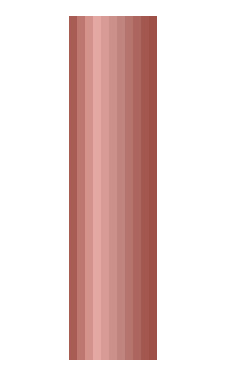

Trombinator - you're example is the best for what i need to do, but i cant get a smooth colour gradient. You can see the steps in it...
http://www.error1.com/images/wire.jpg
And the thinner the wire is, the more the colour steps are apparent, because they dont get smaller when the wire is resized.  When selecting Smooth Colour in the blend options it does not affect it. But i've noticed when bending any of the lines it suddenty makes the gradient perfectly smooth... so this might not be a problem once i've shaped the wire. But how did you bend the wire in your images?

Sorry i'm a bit lost here... Are you saying i can turn lines or rectangles that i've blended into a Brush? how would i do that? because that would make things a lot easier if i can then just use the pen tool to draw them...
Oct 16, 2010 Oct 16, 2010
Sorry, Beany.
Here is a fuller answer:
1) Create a fill/no stroke rectangle with a height corresponding to the thickness and a colour corresponding to the colour at the edges;
2)  Copy and Paste it in front, change the colour to the highlight colour  (which may be white), reduce the height to a small value (depending on  the intended shininess of the highlight), and position it where you want  the highlight if off centre;
3) With both selected, Object>Blend>Make;
4) Drag the blend to the New Brush button at the bottom of the Brushes palette/panel, select Art Brush for a simple brush, give it a name, and leave the default options (not Proportional).
Now you can select any path and apply the brush to it.
For other appearances, you may use other options such as varying width (you may create paths that are pointed at the ends or many other shapes).
You should be aware that only certain objects can be used for brushes; notably you have to use a blend instead of a gradient (you will get an error message about elements that canot be used).
