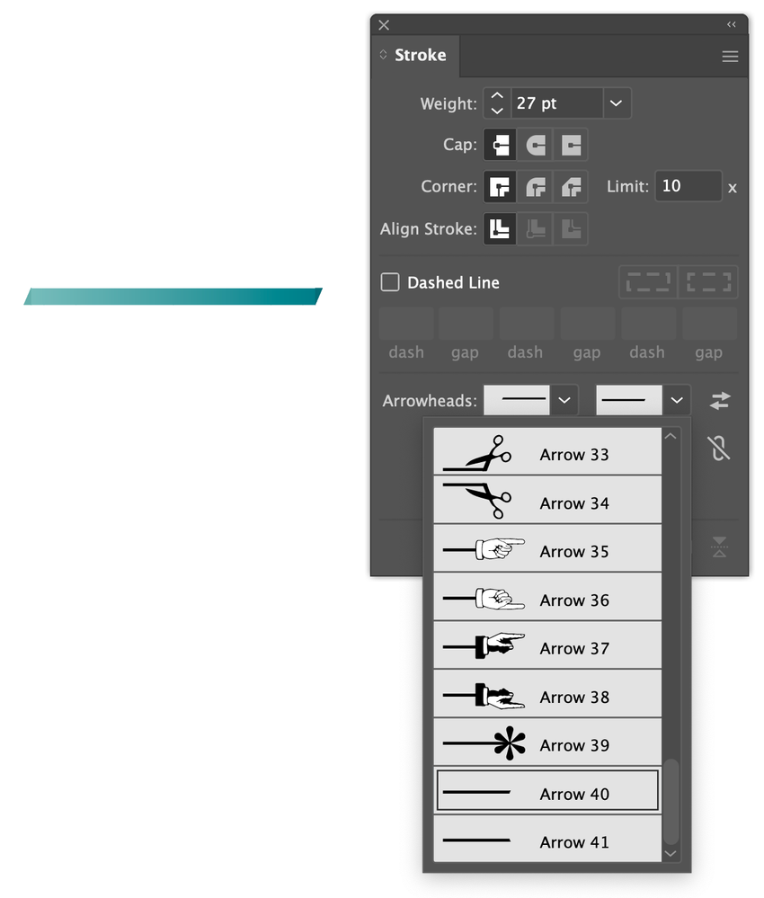

I think that if you want to apply a gradient along the shape you will have to abandon the brush. I have a couple of ideas to offer, and perhaps someone else may have a better one. The first is concerned mostly with the two longer paths, as it does not appear that the shorter one is involved with the gradient, although the same principle may be applied to it if you wish.
Convert or redraw the shapes as closed, filled paths with no stroke, select both, and Object > Compound Path > Make.
With the pen tool draw a single path along the center of the two longer paths, from the start of one path to the end of the other. Do not use a brush, but apply a stroke that is wider than the thickness of the two paths above, and apply the desired gradient along it. Send it to the back, select both the gradient path and the compound path and Object > Clipping Path > Make. If you prefer you may color the compound path white and apply it as an opacity mask (Transparency panel, Properties panel, or Appearance panel: click on Opacity, Make Mask) with Clip activated, or black with clip and invert.
2) The other option is to add custom arrowheads to be accessed through the Stroke panel. The explanation for this process is unfortunately beyond what I can accomplish tonight, but it would allow you to draw the shapes as strokes with appropriate ends, to which you could apply a gradient as with any other stroke. I had not intended to tell you to do a search for how to do this, but that’s where I’m at the moment.
