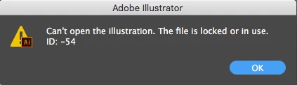

Error -54 in Illustrator CC 2017
I'm getting an error message when I start up Illustrator that says: "Can't open the illustration. The file is locked or in use."  ID:-54 (pictured below)
Someone please help! I've already uninstalled and reinstalled several times.
    安安25097886j5u4Correct answer

    I solved this problem by changing mac's system preferences.
    system preferences > security & privacy > privacy > full disk access > check adobe illustrator and photoshop

    You can dowload the file to your computer. After that you can open it normaly.

    I dragged the file from the saved folder to my desktop and opened it from there... for some reason, it worked.

    Just had the same issue. I was on a PC, using a PC server. Just got a Mac and had an issue with the file not being able to open. I copied it to the HD from the PC server. There was an error message about how I could not copy file ... but it copied anyway???? So ... it opened, I made a change, saved to HD .... THEN copied it to server and opened it ... no problem.

    OK ... problem is when I save .ai file as .pdf THEN open .ai file later ITS LOCKED AGAIN!

    I changed the file name manually outside of illustrator and then was able
    to open the previously locked file.

    I had this same issue with a drive file. I renamed the file in drive, redownloaded and was able to successfully open it!

    For me, the issue was Dropbox smart sync. After CTRL clicking the containing folder and selecting "Smart Sync>Local", I was then able to open the file in illustrator 2020

    What happens when you move the file to the local harddrive?
    Also: is a printer installed, set up as default printer and turned on? If not, install a PDF printer.

    I updated to Illustrator CC2018 and get the same message when I launch the program and try to make a new document.  It makes no sense. Here is what I see every time.  Can anyone please help?

    So this is High Sierra? Is it updated to the latest version?
    Which file system?

    I am on Sierra.  I usually wait just a little before I update my operating system to get the bugs fixed.
