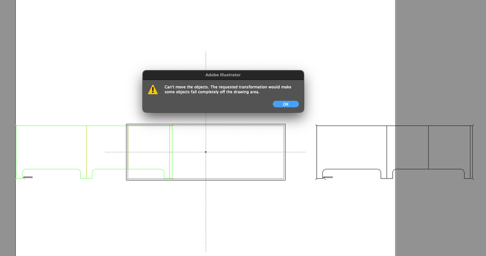

Here is a perfect example, on the right side, you can see that the artwork is happily residing outside of the pasteboard, but when I try to drag a copy outside of the paseboard on the left side, it fails & gives me the error message

CC 27.4.1
OS X 14.4.1
