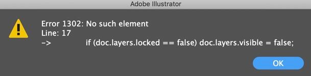

Hello Larry. I'm attempting to use this script in AICC2020 and getting the below error. Looks like this script is 10 years old. Any idea if it should still work or what might be causing my error? Thanks!
Jun 04, 2020 Jun 04, 2020
It may possible while switching old threads to new forum, some of the code get corrupted.  Here is the correct version of the script

New Here ,
Jun 11, 2020 Jun 11, 2020
This script resolved the error I was having and now works. Thanks!
