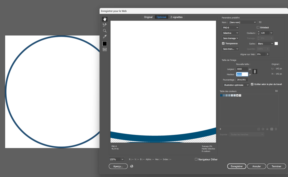

I don't know if this can be considered a similar problem: I have an artifact when exporting a shape to a PNG format file using the "Save for Web (Legacy)" option.
In detail: when the original shape touches the edge of the work surface, an artifact appears at the bottom of the file: part of the shape is duplicated. There is no problem with the "Export for screens" option. Personally, I prefer to use the legacy function but this bug is annoying (I'm using the latest AI 2024 version)

Hello @christophem45831419,
We understand that encountering technical issues can be frustrating. I tried replicating this on my end but was unable to do so. Would you mind sharing some more details, like the exact version of the OS/Illustrator and links to a sample Ai and exported files, so we can investigate this further?

Hello Anubhav,
I'm using AI 28.3 + Window 11.
My test file contains a simple circle drawn on an artboard that measures exactly the same dimensions as the circle.
Exporting it to PNG using Save for web (legacy) should produce the artefact.

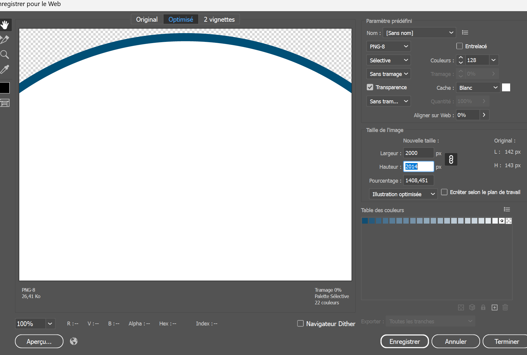

Update : unchecking clip to artboard option resolve the problem, but modify the height of the file (as you can see on the screenshot) and leaves a space at the top of the image.

Community Beginner ,
Mar 13, 2024 Mar 13, 2024
Update #2: the first circle have an outline and a white background.
Test with no outline:
-Exporting with clip to artboard option = artefact.
-Exporting without clip to artboard option = no artefact and dimensions ok.
