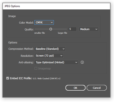

Don't check use_artboards in the first dialog when exporting, you still get the option in the following dialog to re-choose artboard and there's a suffix and prefix area to the right.
As I said earlier I never export to jpg or png, but I thought it was fairly easily found.
There maybe a limitation or other caveat that skipping use_artboards in the first dialog invokes, but try it and see. Monika seems to think it's a bad idea, and she's usually right, but it did work for me and no kittens crying...
Community Beginner ,
Jul 26, 2021 Jul 26, 2021
Using Export As, and leaving Use Artboard unchecked, I do not have an option to select artboard in the following dialogue...
