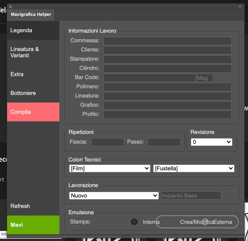

Yes i did, i made my own certificate and signed the zxp with it. The extension can be installed on the other machines but doesn't show the ui...
I attached a screenshot to explain me better

I can see UI on my end.
I have used your code to create ZXP at my end and install it using the installer.
Could you please try using the zxp from the link.
