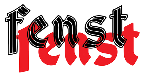

Community Expert , Jan 09, 2023 Jan 09, 2023
In the Appearance panel add a new fill and move it below the characters.
Then apply Effect > Pathfinder > Trim and after that Effect > Pathfinder > Add to that fill (only to that fill). Disregard the warnings. Unfortunately this will also fill the punches.
Maybe you could also add a new stroke in the Appearance panel, move it below the Characters and then just apply a very thick stroke so that the gaps are filled.
Similar to Monika's solution but with Pathfinder Merge.
Object > Expand Appearance will create outlines and the Shape Builder tool (Shift M) will remove the fill in the e when clicked with the Alt key.

Wow thank you both of you !  Appearance, pathfinder and fill for the color  and shape tool to remove the extra color in E did the trick ! I learned a lot with that one !  🙂

The colored path thickness is a little bit too small in my opinion but I'll check how I can enlarge it !
Jan 12, 2023 Jan 12, 2023
I am not sure that I understand what you mean by the colored path thickness is a little bit too small.
It has the same size at the characters.
