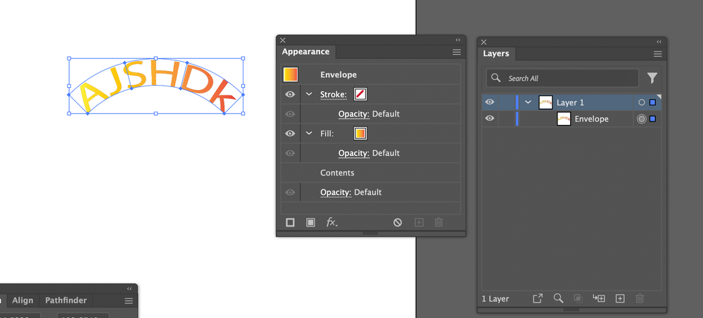

When you say curved text are you meaning type on path or text with an envelope distortion?
An Envelope distort cannot be used as clipping mask, but can be used as opacity mask.
If you select the envelope in the layers panel you should be able to add a gradient to it's appearance in the appearance pannel. See screenshot.

Could you show a screen shot (with layers and appearance panel showing)? You should be able to do this without a clipping mask (unless it is a freeform gradient)
Sep 02, 2023 Sep 02, 2023
As Lukas already mentioned, no need for masks.
It is best to remove the default black fill for the text and set it to none.
Add a new gradient fill in the Appearannce panel and distort it (with optional distorting the gradient in the Envelope options) or put it along a path.
