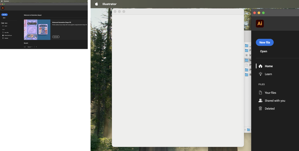

Sep 19, 2025 Sep 19, 2025
Hi @A. Patterson , I need some more help. I am trying to build the same plugin on Mac. I can build it on macOS and resolve the dependencies, but I am not able to see my plugin UI. After the plugin loads, Illustrator does not show any menu bar, and a panel window with a default size stays open. Please refer to the screenshot.Plugin_Load_Mac.png
I have modified the Mac-specific code in AddWidgets() as shown below:
#ifdef MAC_ENV
_containerWidget = new TestColorWidget(nullptr);
AISize panelSize = { 0 };
error = sAIPanel->GetSize(fPanel, panelSize);
UpdateUIOnPanelResize(panelSize);
_containerWidget->show();
NSView* qtView = (NSView*)_containerWidget->winId();
[hDlg setFrame:[qtView frame]];
[hDlg addSubview:qtView];
// // Get our own bundle
// NSBundle* bundle = [NSBundle bundleWithIdentifier:@"com.adobe.illustrator.plugins.EmptyPanel"];
// // Load the nib file
// CalcController* calculator = [CalcController alloc];
// [calculator initWithNibName:@"View" bundle:bundle];
// // Set panel to be our nib’s view
// NSView* newView = [calculator view];
// [hDlg setFrame:[newView frame]];
// [hDlg addSubview:newView];
#endif
Below are my development environment settings:
MacBook Pro
Chip: Apple M1 Pro
macOS Sequoia 15.6
Xcode 26.0
Adobe Illustrator 2025, Version 29.8.1
Am I missing anything? If I remove my Qt-related code, I can see the EmptyPanel UI without any issues. Thanks in advance!

However, the same behavior persists. This time, I am unable to see the blank panel with the default size (600, 600), and Adobe Illustrator is not showing any menu bar.  I am also receiving the "PanelSizeChangedNotifyProc" callback but not PanelVisibilityChangedNotifyProc.
Any additional inputs or suggestions would be greatly appreciated to help resolve this issue.

I'm afraid we're beyond what little I know about this on Mac. The only other thing I can think to try would be making the widget 2x or 3x bigger than you want to make sure it's not hiding behind the AI panel. Maybe z-order is an issue? Beyond that I honestly don't know. We haven't worked with Qt 5.x in about 4 or 5 years
Explorer ,
Sep 20, 2025 Sep 20, 2025
Hi @A. Patterson, I have increased the size(Hard-coded to 1500 X 1500) but no luck. I will debug further and update here my solution later. I am also a windows guy. Thank you for the feedback and inputs.
