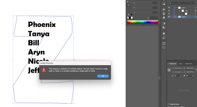

Hi, I'm having this problem and unfortunately this didn't solve it for me. Here is a screenshot of my items, with the shape on top and text below:
Oct 25, 2024 Oct 25, 2024
Please open that layer, so what we can see what the path is. Maybe it's still grouped or a compound path.

The shape (Z) started with text which I outlined, does that not work for this purpose?
It's still grouped. You need to ungroup it. And then release the compound path. Object > Compound path > Release

Oh thanks so much! Now it works! It worked wrong lol, but it still worked! 🙂
